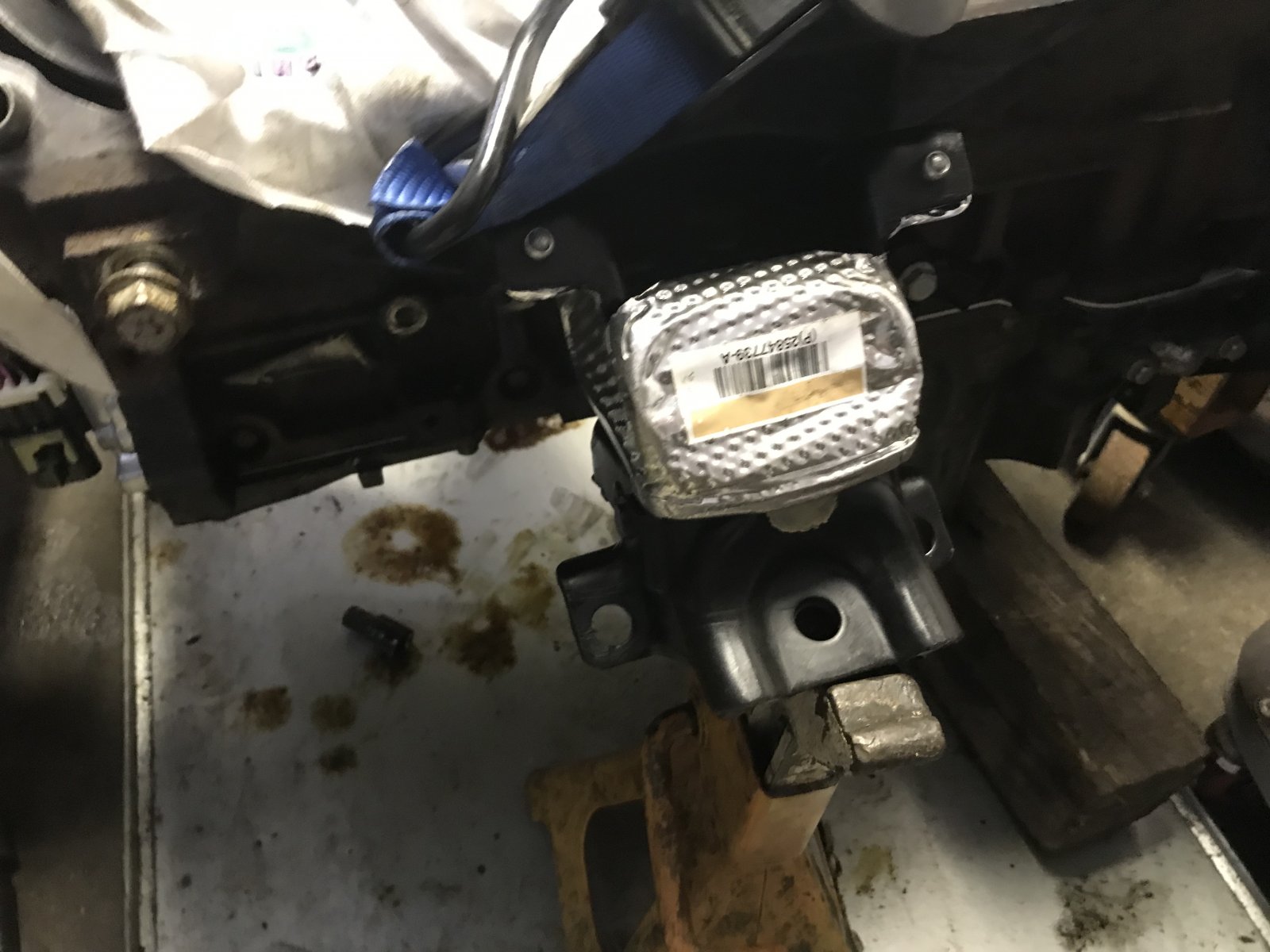

Replace all three at same time regardless of whatever you choose. The weakest motor mount immediately begins wearing out the newest mount.
Motor mounts are tuned. When they wear, they rely more on the other dampeners to compensate. There actually is a scientific equation to each mount set up based on lifespan, comfort, performance, etc.

Can anyone advise me on how difficult it is to change all 3 motor mounts on a 2007 Yukon XL Denali (6.2L)? I don't believe that I have a broken one, but with 135k miles on it, perhaps it makes sense to be proactive, if it is not a major pain in the ass to do so.
randeez
Sep 29, 2017
7,444
23,678
south florida
2wd or awd?
2wd easy from the buttom, just support engine and pull one at a time. with front diff just requires a little more time to work the bolts to the engine block, with stock exhaust manifolds it shouldnt be bad
transmission iirc is on a removable cross member. support transmission/tcase . unbolt it and the crossmember to swap
