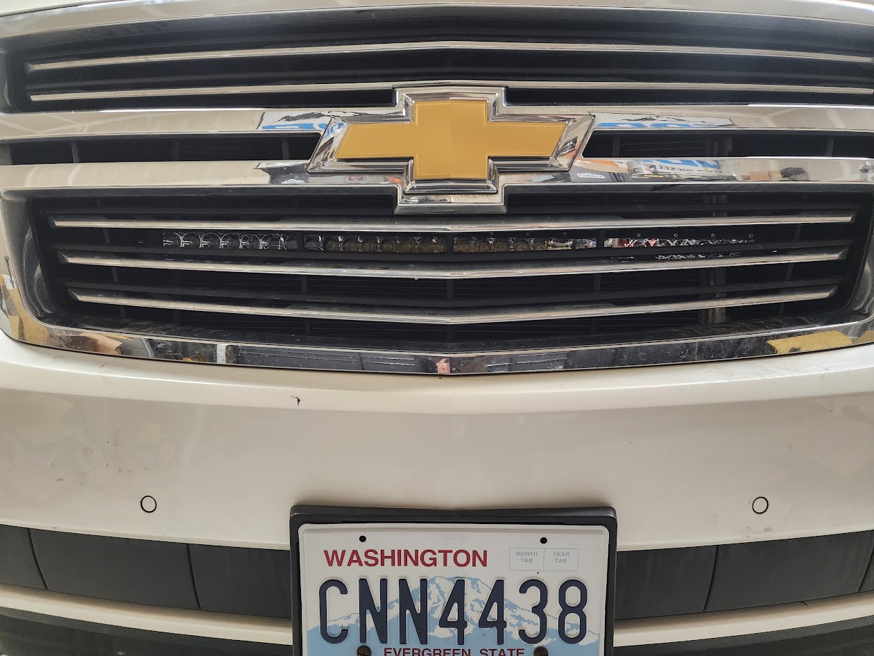

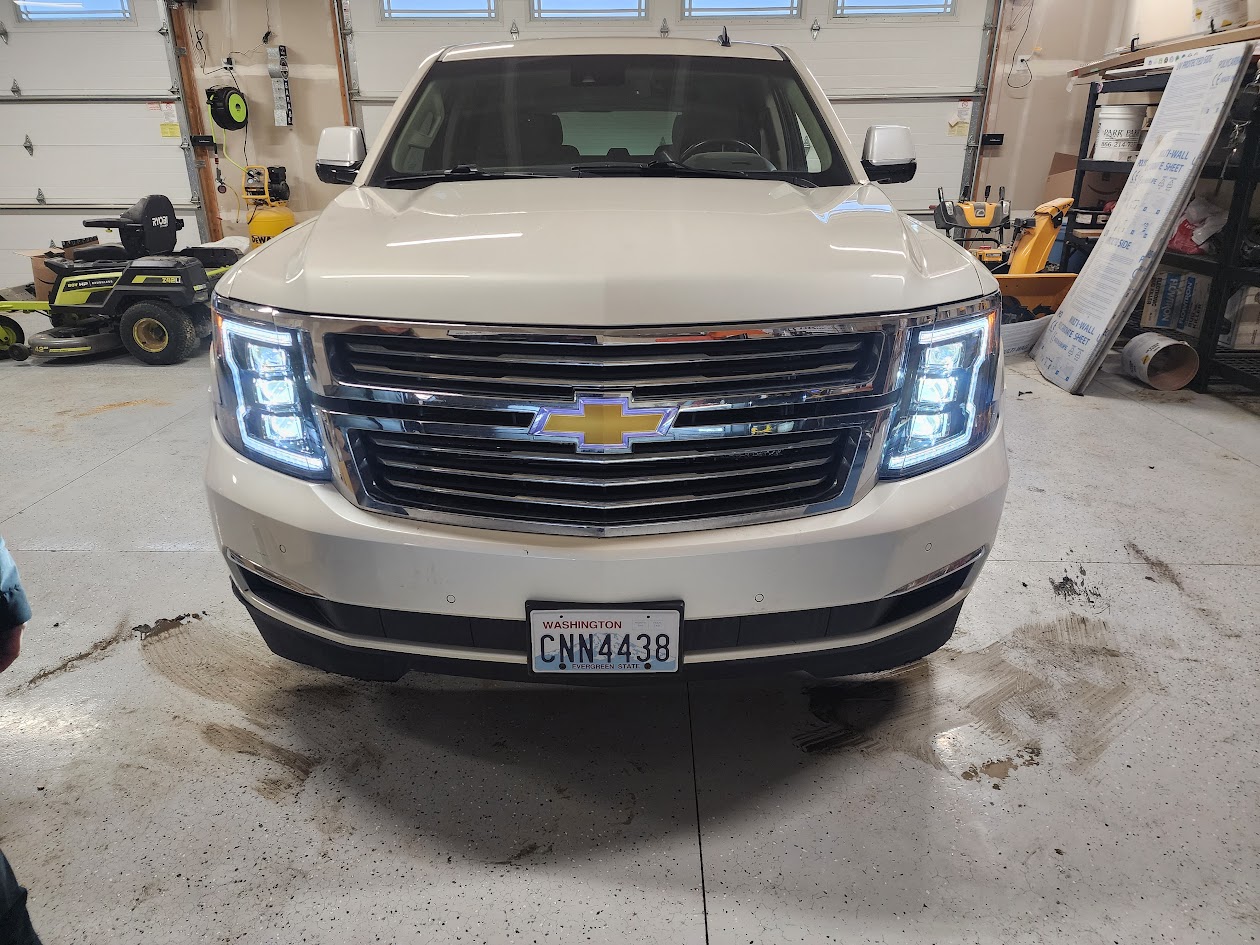

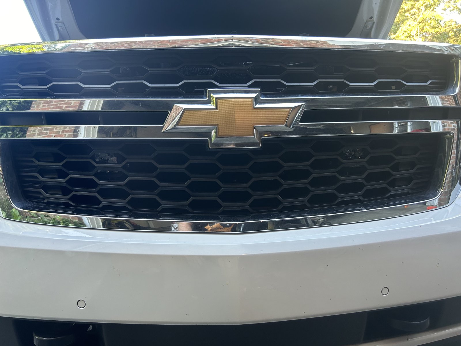

And i suppose i should mention, i threw this in as well yesterday
I'll be honest, i'm kinda disappointed in the brightness of it. For being a genuine GM product, i expected the glowing ring to be brighter and more like a DRL. It's noticeable at night, but i was just thinking it would be brighter...But regardless, that's another project done on the burb, so i have less to do tomorrow morning.
Loki223
Loki223
Apr 27, 2023
146
178
Elk, WA
And for the sake of others, GM P/N 84751545 is for the LED back lit bow tie on the grill. it is basically plug and plus, you bore out a hole behind the emblem and connect the wires. The kit has you insert the wires through the grill, and then insert the wire ends into a plug. They snap in, black to black, white to grey is what i did. as it made the most sense. From there connect it to the supplied T harness that runs over to the driver's side headlight. It honestly only took a couple of minutes. Pull the plastic cover off the top of the grill, i used a long screw drier to release one of the clips on the stock bowtie from behind. and pop that off. drill the hole, run the wires up and connect them into the plug, then route the wire where you want it and put everything back together. Took longer to hunt down the correct PN then it did to actually do the install
