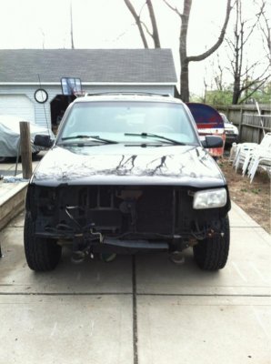

When I first bought my Denali back in January had some grill damage from the previous owners collision with a deer. The damage wasn't bad at all, I only had to replace the grill and the passenger side turn signal and headlight. Since I've had it the bumper seems to be tilted down and I have about an inch gap between the fender and the bumper. I've taken the bumper off not to long ago just to poke around and see if I could find anything wrong. I really didn't see anything that was messed up besides when I held the bumper straight where it's supposed to be, the holes didn't line up anymore. Is there something that could be wrong or should I just replace the bumper support brackets.

Just some pics for reference

when I picked up my 95 Tahoe it has the 99-00 Escalade/Denali conversion I had a similar problem with the bumper ended up getting the left and right bumper brace from the dealer and it fits perfect now

dealer is pricey...see if you can get the part numbers and cross reference them at gmpartsdirect.com or rockauto.com

If someone could find this for me that would be awesome. I'd rather not even bother with dealer prices.
