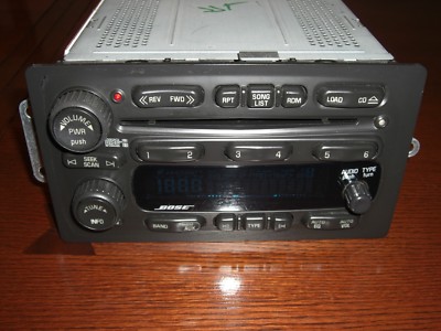

Radio unit is:
UC6 RADIO - AM/FM STEREO, SEEK/SCAN, RDS, MULTIPLE COMPACT DISC, AUTO TONE CONTROL, CLOCK, ETR
I have no idea where the multi-disc changer is. Do they load into the one slot on the head unit or is there a cassette box in the dash?

I bet it's the CD player/changer.
Our 2002 mustang has a 6 disc changer built into the head unit and it doesn't work half the time and makes noises just like that.

UC6 is multi disc in the head unit. Could be the disc drive attempting to read a disc, even if there isn't one in the slot.
EDIT: I think multi disc means it can play different types of discs (e.g., CD-R)

Sound seems lower and to right of the head unit. Like I said, I don't know where the changer is or if it even has one.
RPO code said multi-disc, but doesn't mention nav. Owners manual for nav mentions single disc using slot above screen, but no mention of owning multiple discs..disc's... Confusing.

EDIT: I think multi disc means it can play different types of discs (e.g., CD-R), not that it can hand multiple disc with a changer. Now that I think about it, mine was a single disc unit and I replaced the drive when it failed. Not a changer.
