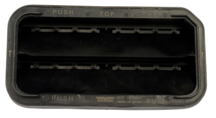

The only time I have anything similar to this is when one of the windows is open a bit. For my Yukon and my previous 2018 Traverse, there always has to be at least 2 windows open at the same time to prevent negative pressure in the cabin.
Most vehicles have a Cabin Pressure Relief Valve to prevent over-pressure situations inside the cabin. But these are usually one way out. They don't let air into the cabin. Incoming air usually comes from the HVAC system.
If the Cabin Pressure Relief Valve is blocked/broken somehow, the cabin could overpressure, particularly with higher fan settings. This could potentially cause ear pressure issues.
You would also notice that it's a little more difficult to close a single door due to overpressure in the cabin. These are most often located on one of the rear quarters near the liftgate. But I'm not sure on the 2021s.
