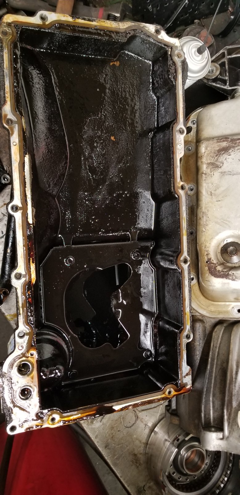

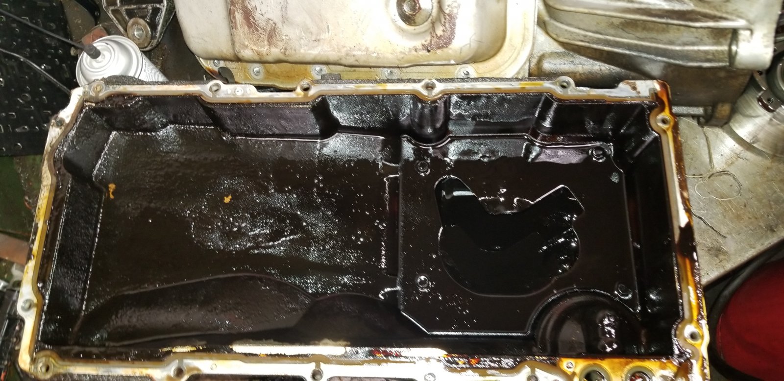

I’m going to replace the pressure sensor and either remove or replace that screen entirely. Will see what that does. If that does not resolve my issue I forgot to mention I do have a pretty bad rear main leak. But according to my research it shouldn’t bleed as much pressure as I’m losing now. But once I replace those two items i believe im left with the oil pump itself, or unfortunately bearing wear which to me seems highly unlikely as this truck was owned by two very old ladies. And did their oil changes on time judging by the very clean state of the oil pan with virtually no sludge. Original gasket on it the pan has never been dropped before I did it.
