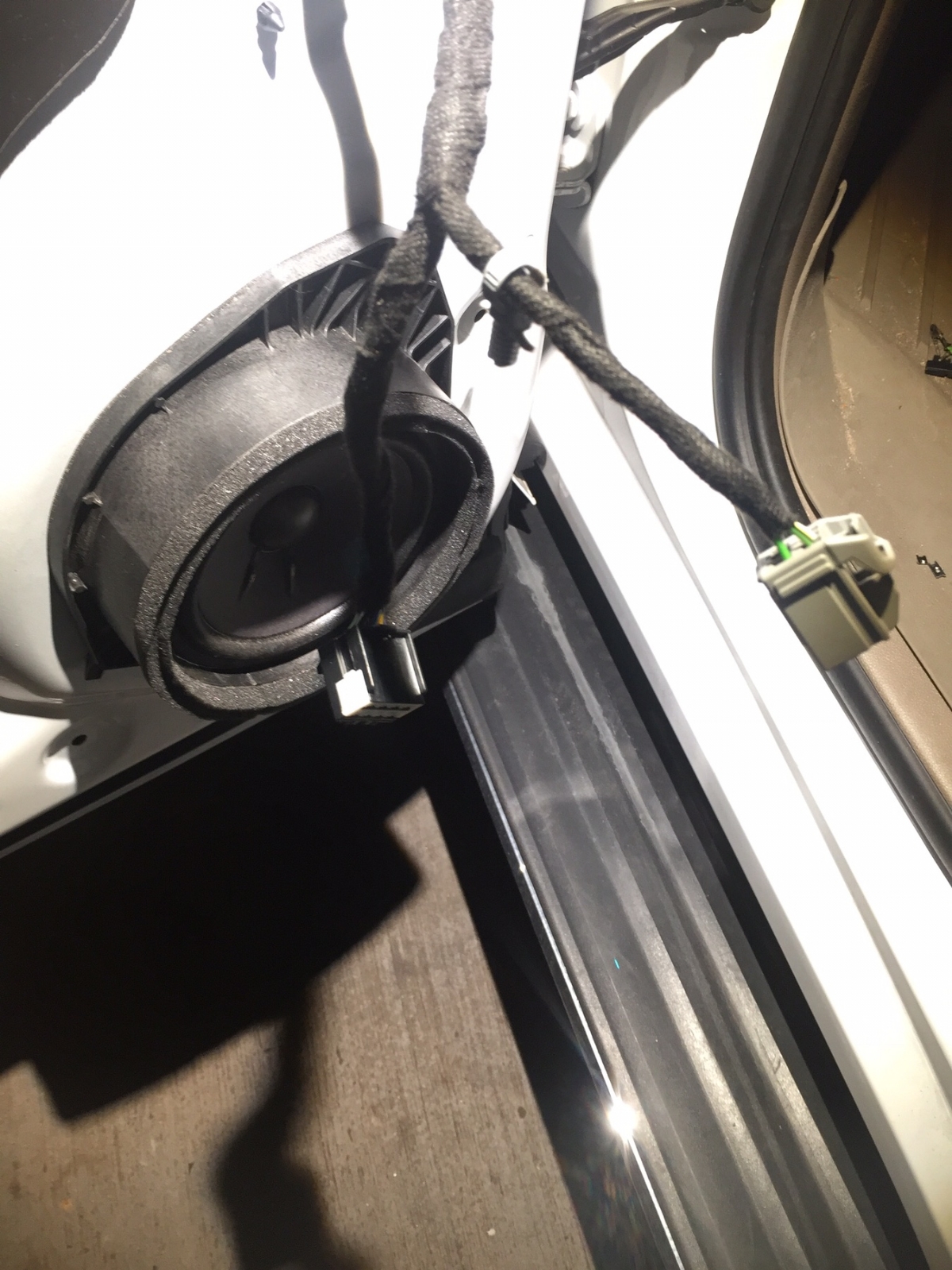

Yes with the exception of one connector that goes to the led light in the rear interior door handle cavity. The Esky has a 6 pin connector (only 4 pins used) because it has an additional speaker in front of the door handle. The Tahoe/Yukon only has a 2 pin connector for the led light.

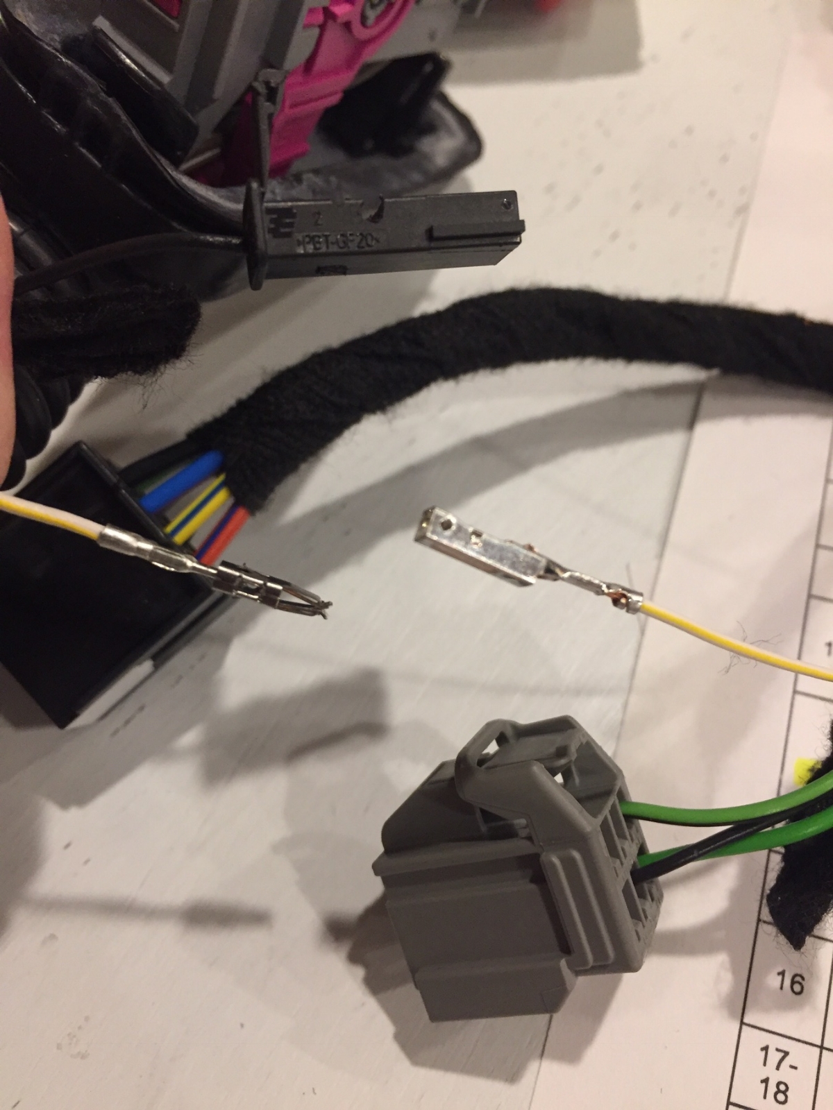

The Tahoe/Yukon connector is the black one on the left. The Esky is the gray connector on the right.
The connectors use different terminals. I had to crimp on the correct ones to fit my Yukon connector. I could easily make a pigtail to convert the Esky connector.

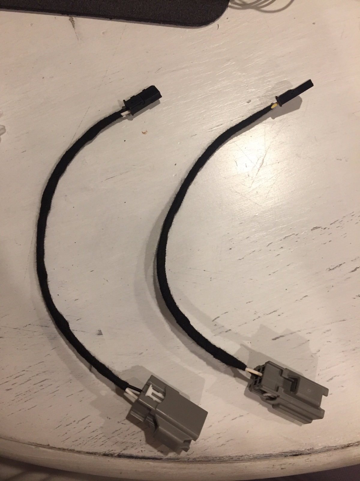

Does that include the harnesses for the rear doors as well ? there all plug and play except for that one connector ? would you be willing to make pigtails for all for and ill $$ you

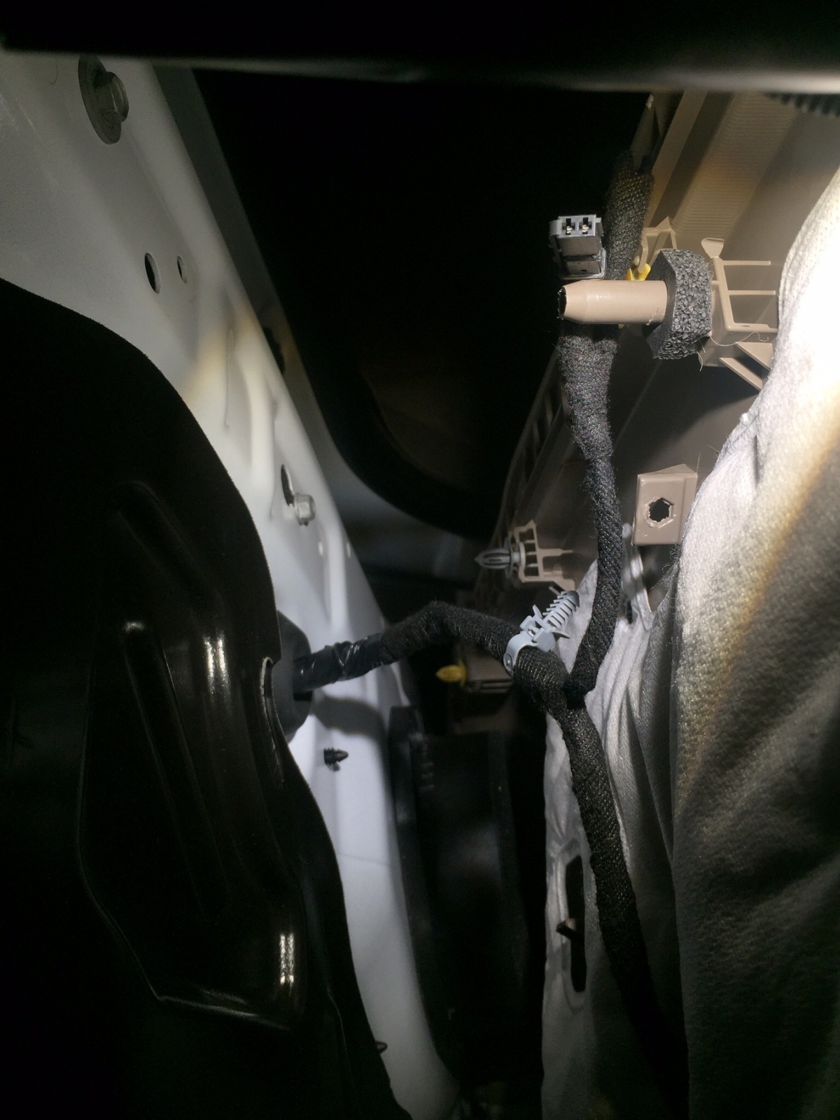

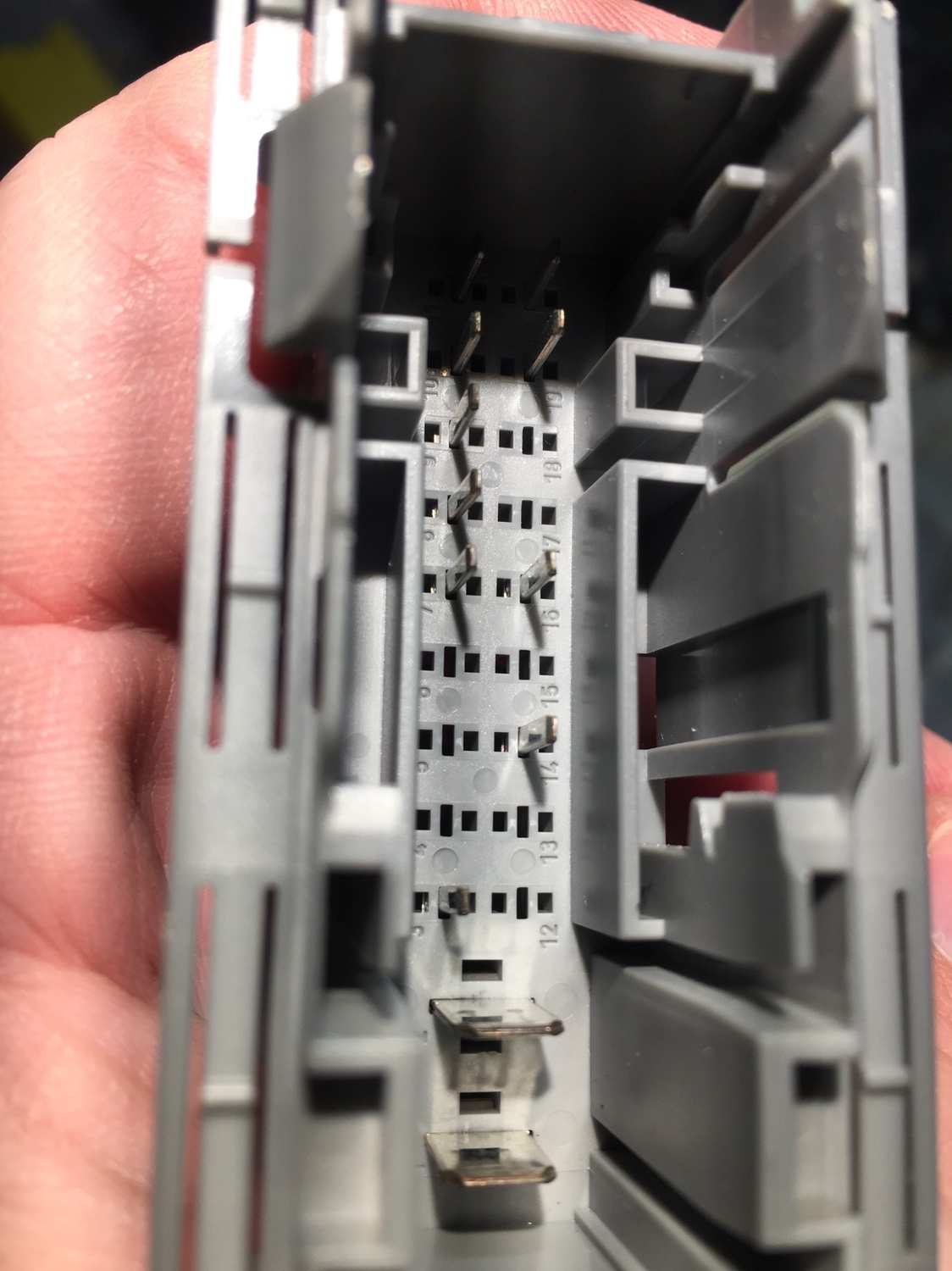

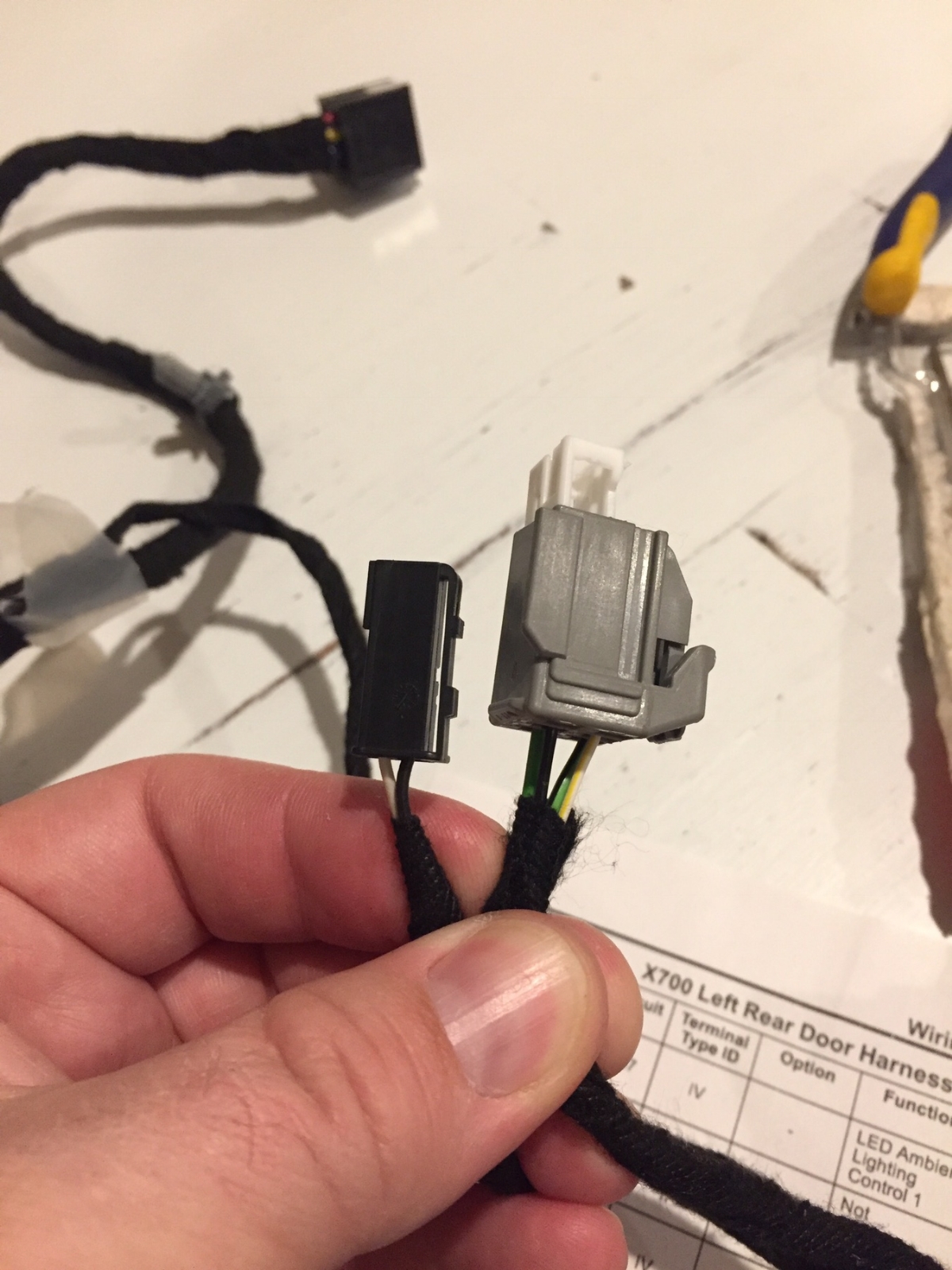

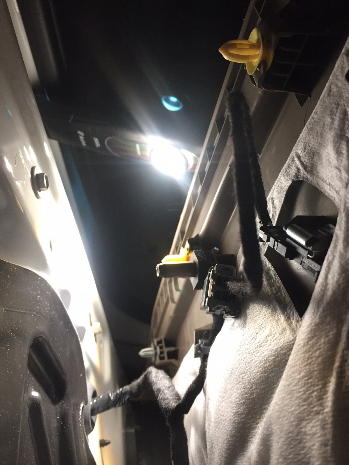

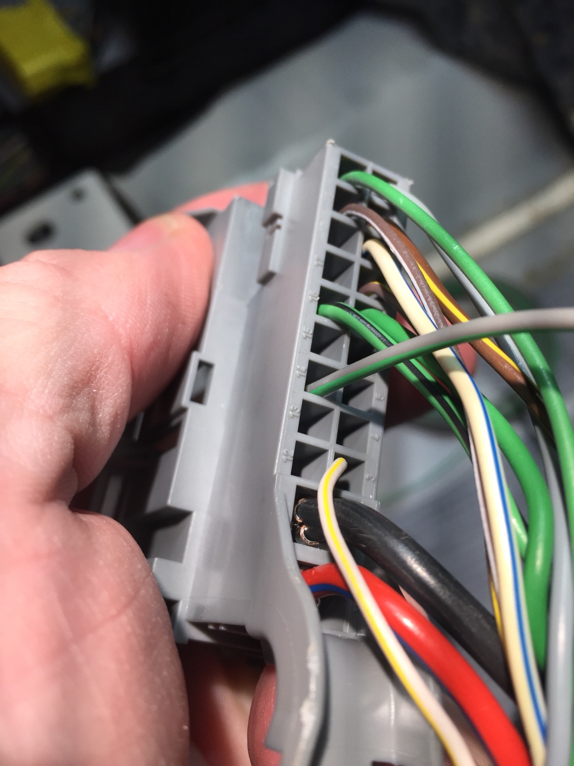

The front door harnesses are plug and play. However, for the rear doors, a puddle lamp circuit needs to be tapped into and a wire ran to the body side of the rear door connector. If you already have mirrors with puddle lamps, the wire will be in the run along the door sill.
You can see where I added the gray/green wire to position 14 of the body side door connector for the rear door.
Rear view of connector
Front view
I’m happy to make the pigtails. I need to make sure I can source the mating connector. I’ll report back.
