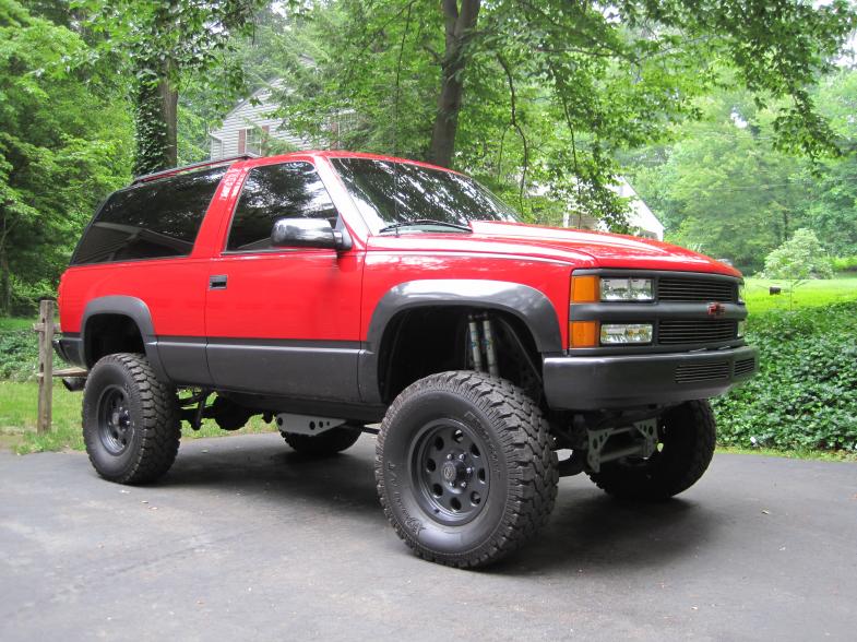

RCX kit will yield 5.125" plus a crank. That plus a body lift and trimming will get you on the 38.5" tires...dependent also on back spacing of wheels and wheel width.
Oh yeah, your whole front end is going to hate you. Your bank account is going to hate the front end....it is a viscous circle.
Jokes aside, our 1/2 ton trucks wear out quick with big tires like that.
My tahoe is 8" above stock and I still trimmed a little because of some tire rub during wheel travel and turning and so on. Just be prepared for some extra stuff to pop up. I'm no pro but I've built two rigs now with IFS. I will not run over a 36 on mine
