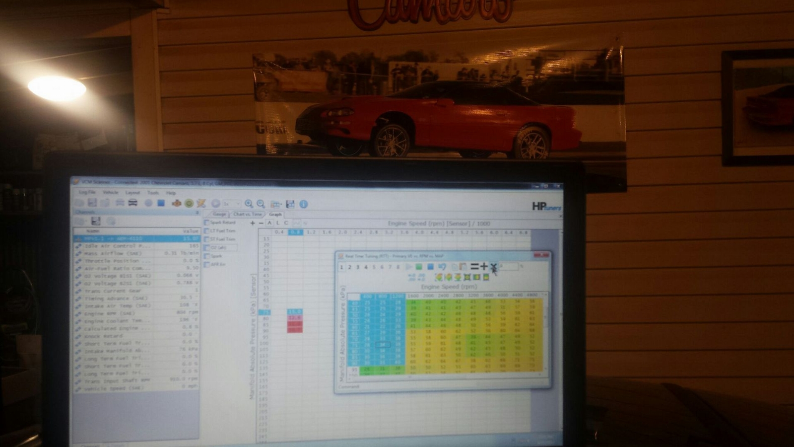

I had a new wideband installed and did log the runs and the afr was pretty dang close and timing is maxed out I believe.....
