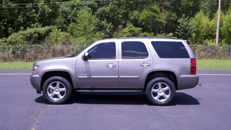

On my 08 LTZ I didn't notice any ride difference whatsoever. The only difference was that the view out the windshield higher! Steering was fine but I had slight rub on the front fender liner (275-60/20 Nitto Terra Grapplers) but nothing that couldn't be fixed. I didn't like the look so I took it off, but it wasn't as a result of the kit itself. I think it would be great on a Z-71

Exactly.. The CCM is a 2.5" front 1" rear. With shipping and all it was $141 from Cali to Tennessee. Kit is $129.
