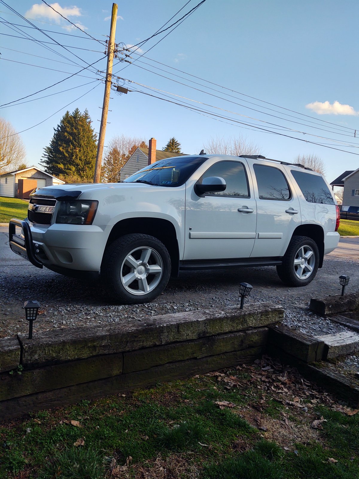

Yes I am pretty sure that is it. They sell for around $160 on ebay.
Do you know if technically 35s with cutting would work and also would it work on 2022 I know I used that kit on my 2010 but it still looks the same and not updated and worry it won’t work on the 2021s
