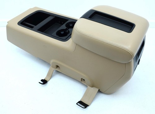

Hello Jay,

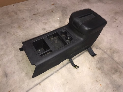

I have the impression that most of them come with "something" in there, usually audio, sometimes, audio/video, sometimes AC controls, and probably rarely a "cubby" (that is how I found out there are cubbies for it).
It seems (of course) that the rare ones are more expensive. So if you want to go 'basic' just get the best bang for your buck model (on ebay or so) for your truck, and take out what you don't need.

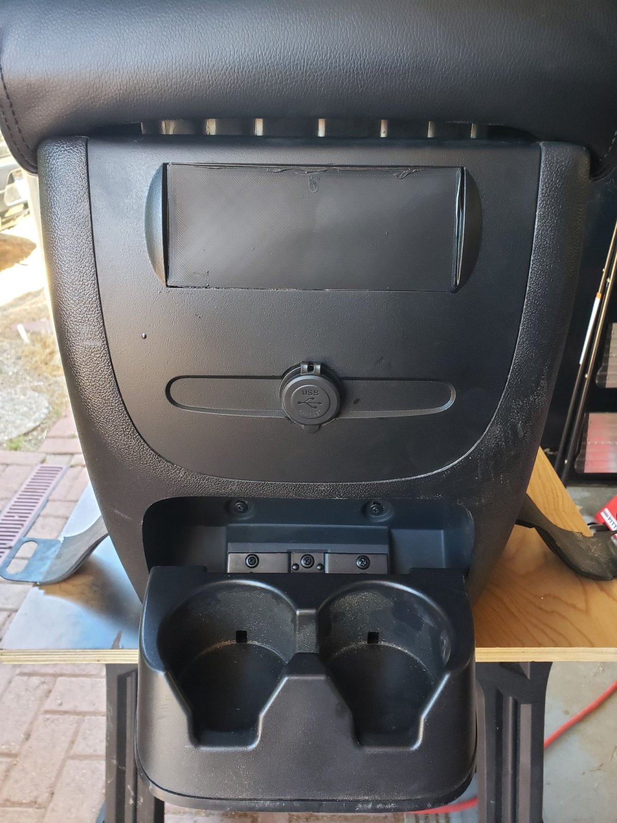

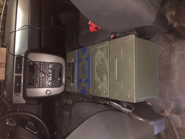

I cut off the connectors from the (typical) part of harness that is in there and wired it up with a few feet of red/black wire so I can reach the keyed power near the roll over sensor, and hook black to the dash/steering column frame. (I also connected the wireless phone charger, that I built into the console lid, to it, and a CB radio)
My center console came out of a Silverado LTZ, Chevy Silverado's )etc) Chevy Tahoe, Suburbun, GMC Yukon, Cadillac Escalade (sp?) use a lot of the same trim/interior parts, it is just a matter of looking around.
Mine I bought for around $150, but needed a new rear trim piece, a front "extender" and of course that cubby. The nice thing about that console is that you can buy pretty much every part for it. (So if you find an inexpensive one, but with a crappy lid, you could replace the lid or the skin. There are trays, cup holders etc etc etc. Just browse on ebay or so to see what options you have.
(A bit over a year ago I jumped on an old thread about center consoles and Radio upgrade (to Nav etc), ever since I have see these old threads revived avery few weeks/months)
Ron

Hi Stephen
For the USBs (charging only) I got a GM part, that had the whole panel and used the USB ports, that was way cheaper than getting the individual USB/lighter ones (you'd need a power converter though to go down from 12v )
Ron
PS: it's the part below the radio, there are two cigarette sockets, and the buttons for traction control, pedal adjustment etc etc. The one I bought had 2 sockets instead of cigarette lighters. The complete parts was something like $30, about the price of one USB socket. (the part was old model overstock, the USB sockets I found were not)

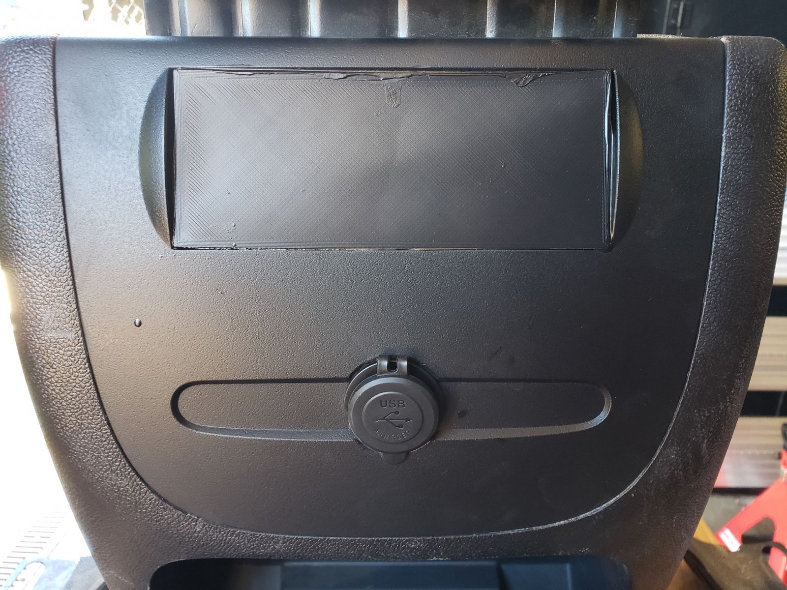

I pulled mine from a wrecked Hybrid. Ended up paying $100 for it, then had to repaint it (i needed black and bought grey) so that came from touchupdirect.com (2 cans) + matt clear (2 cans). I then purchased a new armrest cover in black on eBay for like $30 and paid around $20 to have professional installed by upholstery shop.
Pulling the center console yourself is a fun challenge. I had to remove the two front seats as the seats cover the console mounts. Installing is the same.
The console I pulled does have the rear air controls. Can’t use so I removed it (and will sell one day on eBay) and in it’s place, glued a small piece of Plexyglass in its spot. In the past I added 5% window tint on the plexyglass then glued in. This time I used high gloss vinyl wrap. Saves about $75-$100 trying to find a rear panel with the cubbie (like others have recommended). Plus with the small portion of plexyglass, you can cut in HDMI, USB, headphone connectors and more to connect with aftermarket radio.
