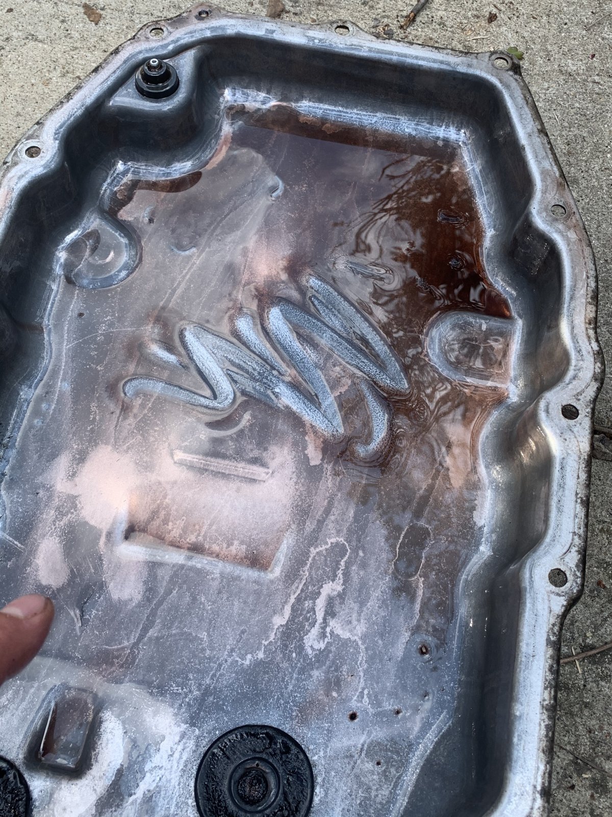

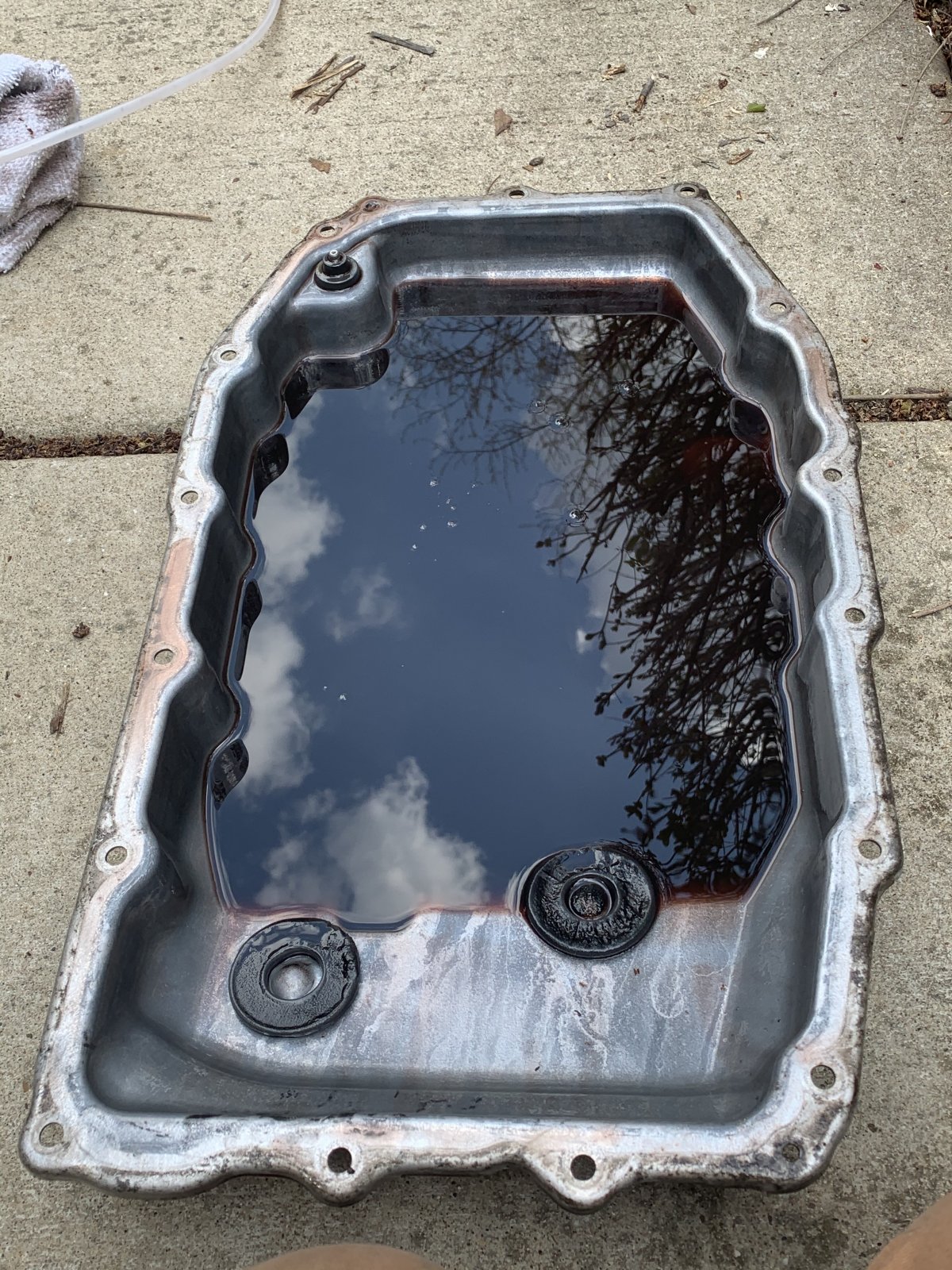

I followed a YouTube video and changed my 8l90’s filter and fluid today.
I had dealer do the first time at 45k. 34k later it’s my turn.
I bought a fluid extractor to suck most out of the pan first.
The most time consuming step was getting the darn heat shield removed. The rest was easy. I took my time - like really slow and it took 2.5 hours.
I have a scan tool (ScanGauge II) to measure fluid temp- needs to be between 95-113 degrees.
Did not have to bend the exhaust cross over. I was able to easily slide pan out by turning front side (facing front of car) towards passenger side.
Filled with 8 qts and about 1/2 -3/4 qt drained out during level check.
Magnets were dirty, fluid was dark, didn’t smell bad . Pan was a little dirty.
You can do it on the driveway, just take your time.
I plan to suck out pan and refill in a few weeks again to refresh more fluid. Then going forward, suck and fill each year.

Are there any others on this forum that have done the 8l90 fluid change themselves? Interested to see what their pan/ magnets look like.
I had mine in for right side tail light replacment and had the dealer pull the pan and replace filter (38,***). It looked much like your second pic, no burnt smell and there was material on the magnets.

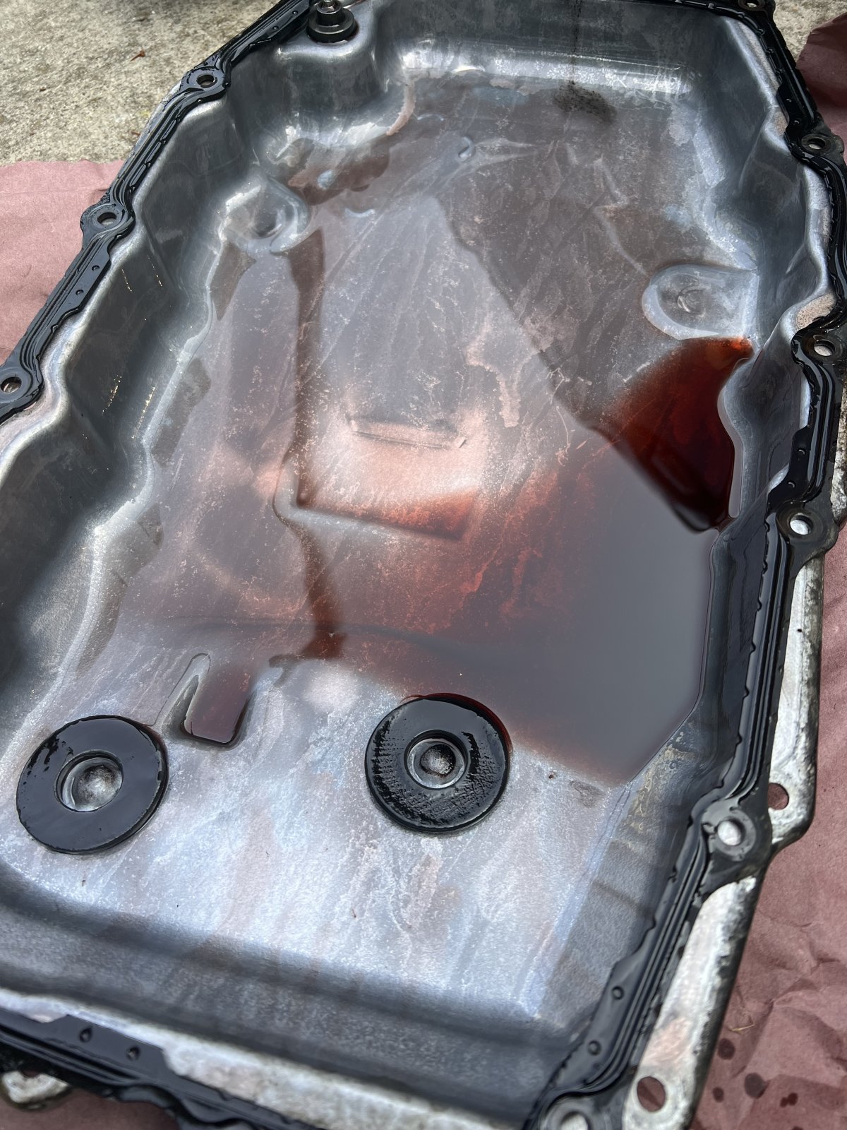

I paid the dealer to do mine at 38k. I do have the 10 speed though. Fluid looked much darker than I expected (they got a quart of the old fluid for me) but like you said, didn't smell bad. It had a different smell than what I'm used to. I obviously didn't see the pan
