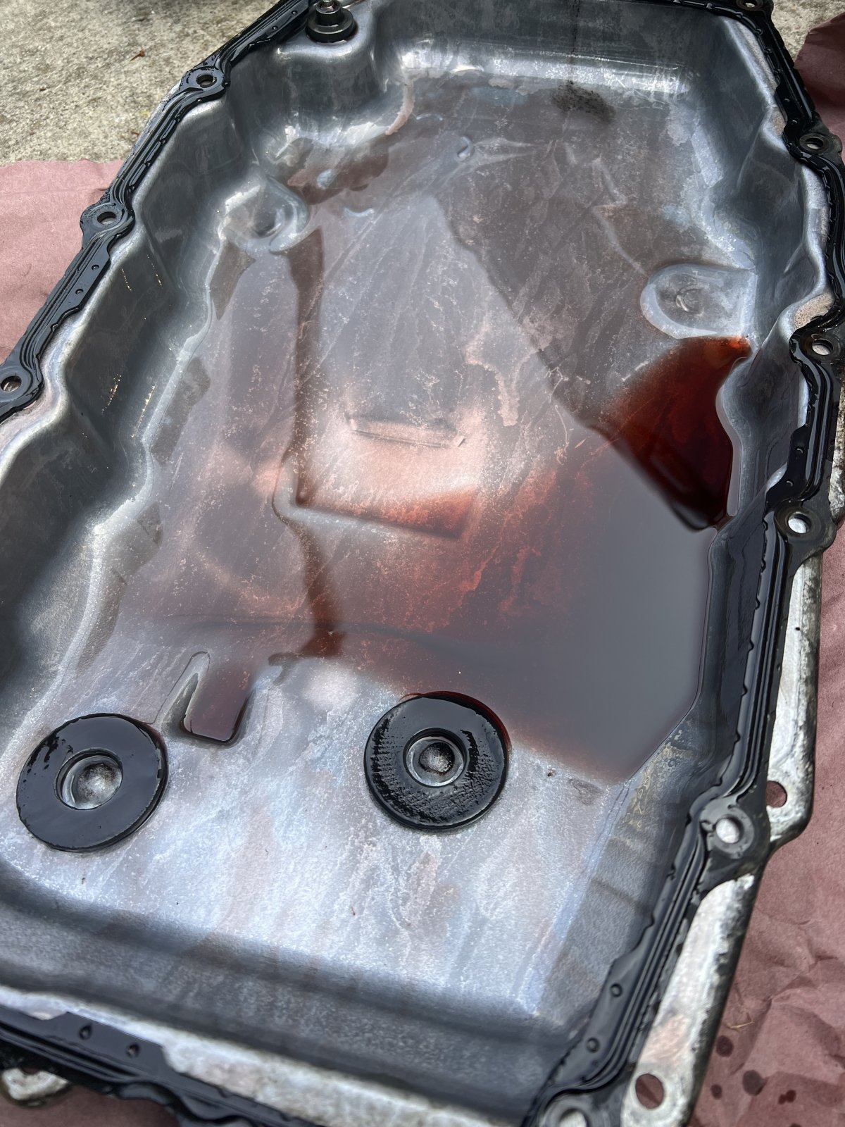

Changed my filter and fluid on 8l90 8 speed today
richardault
Dec 27, 2024
OP again. Changed again today (fluid and filter) at 130k…. 31k on the fluid. It was still pretty red and not much paste on the magnets.
Also, added the SureCool thermostat to lower trans temps. Good stuff!

OP again, another refresh at 155k miles - about 25k on fluid.
Just did two extract and refills - 6 quarts each time, then level check. No pan drop with filter change.
I took a quick few minute ride between drain/fill #1 to fully circulate the fluid.
First extract was definitely darker than second.
I plan to do this every 25-30k and hopefully keep the truck running well.
It does shift noticeably smoother after the exchanges.
