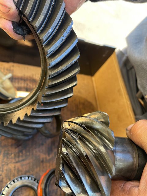

Update on the noise - I had the front diff rebuilt locally for $800 including R&R at a reputable shop.
The shop said my original gears were burnt and that was about the only thing they could visually see wrong with it. Below is a pic of the gears, I see an imprint on every tooth of the ring gear so maybe that was my clicking?
Who knows, all done with now and back on the road!
