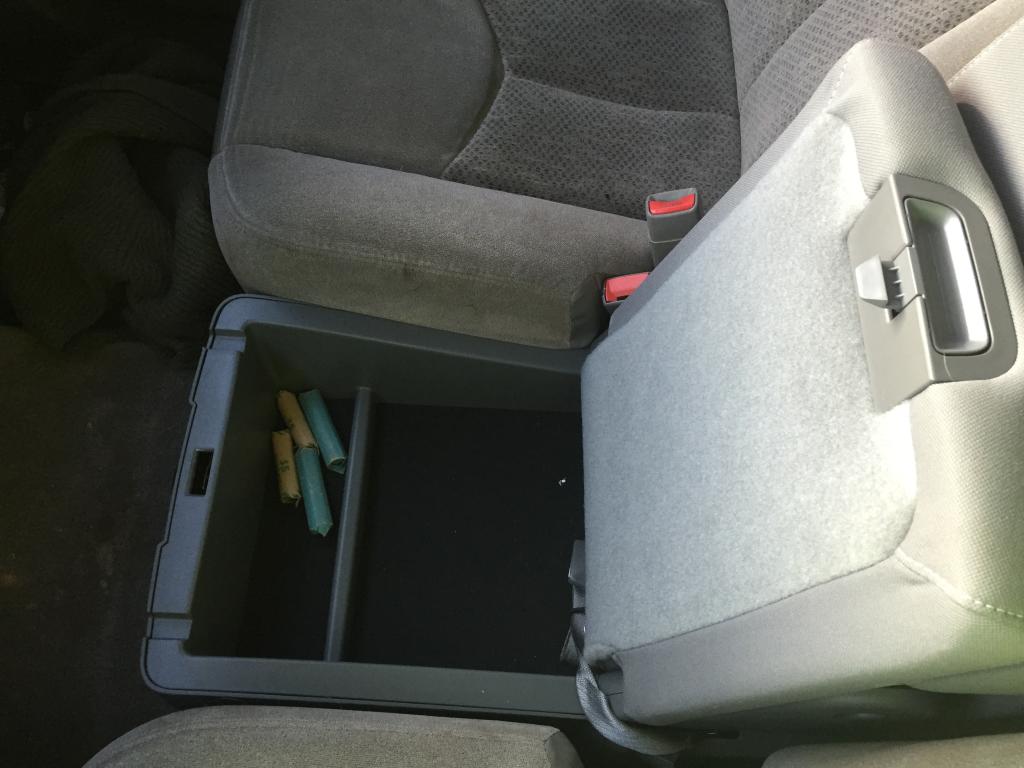

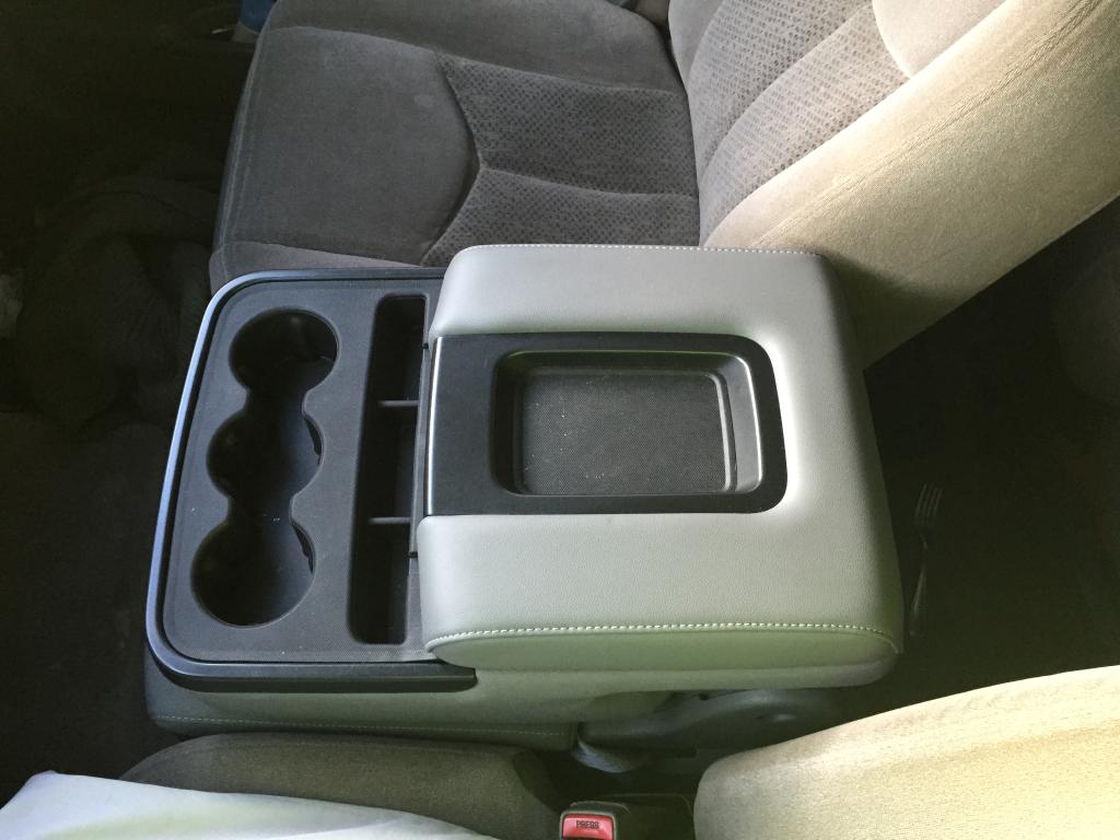

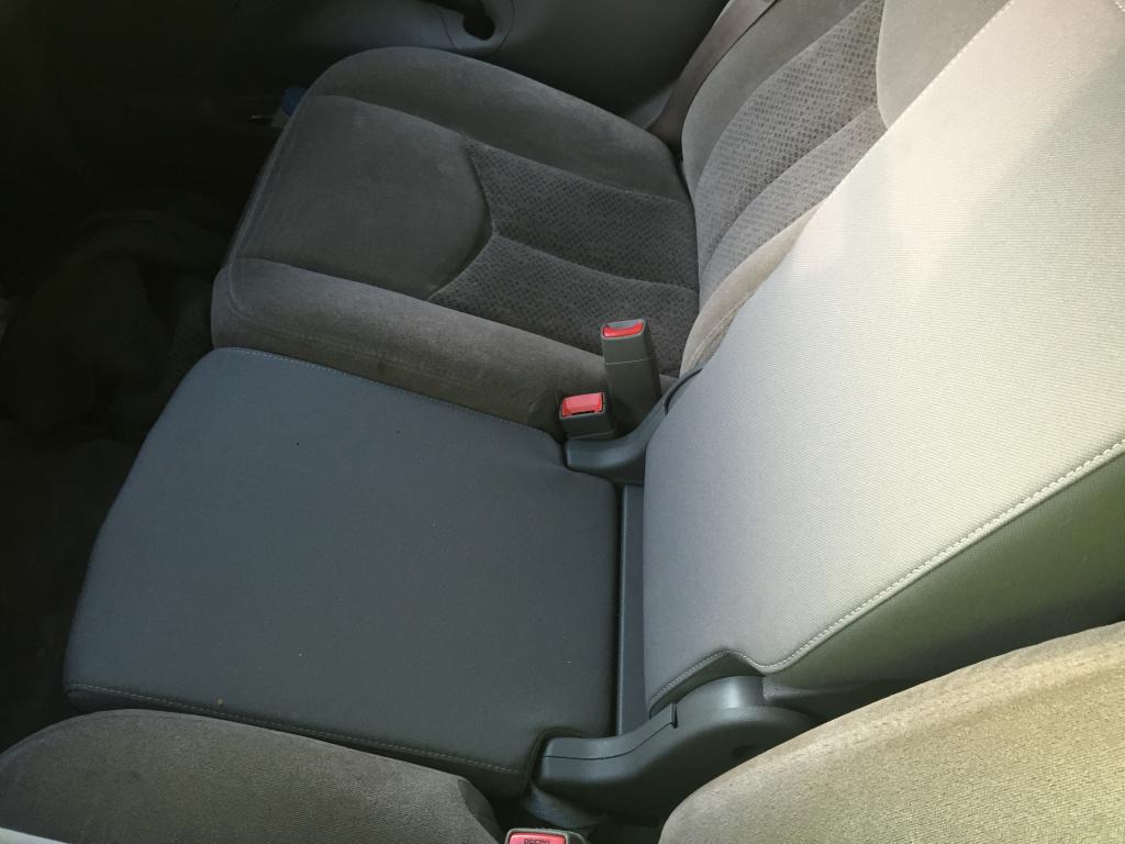

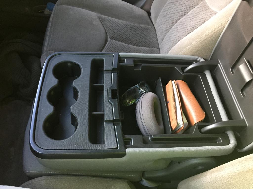

The fit is good. For the moment it is sitting along with the loos seats set in place. Welding up the frame swap is next. And once that is all dialed in and I have the 12v wiring addressed. I will address color matching once I have the frame done. But for now. She fits like a glove.
