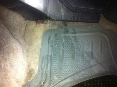

Crazy. So this morning I was driving to take my GF to work since I am gonna do her oil and tune up today. She said their was some "weird green liquid" on her floor mat. I looked tasted it (thinking maybe the puppies pee'd or something) Nope it is a bit of coolant. Now since my heating and cooling do not work right at all. I keep having to try and get the windows and defrost on full blast to keep the windshield from fogging up. Could this be why? Photos coming in a minute they are on my iPhone.

Here is some photos

It looks like your heater core is shot. I`ve never changed one on these trucks so i don`t know how tough it is to replace it.

If not in a hurry block it out for now because the entire hvac box has to come out and among other thing your a/c will have to disconnected and your system opened so be prepared to do some serious work.
Bypass the heater and stay in Hawaii .....:)

I wish. It's 85 their and 52 here.
---------- Post added at 10:34 PM ---------- Previous post was at 10:33 PM ----------
SunlitComet said:
Koa, let me know if the core panel idea from youtube works.
Will do I am debating on doing it now it's dark but needs to get done before 8am tomorrow since I gotta drive down to fort lewis.
