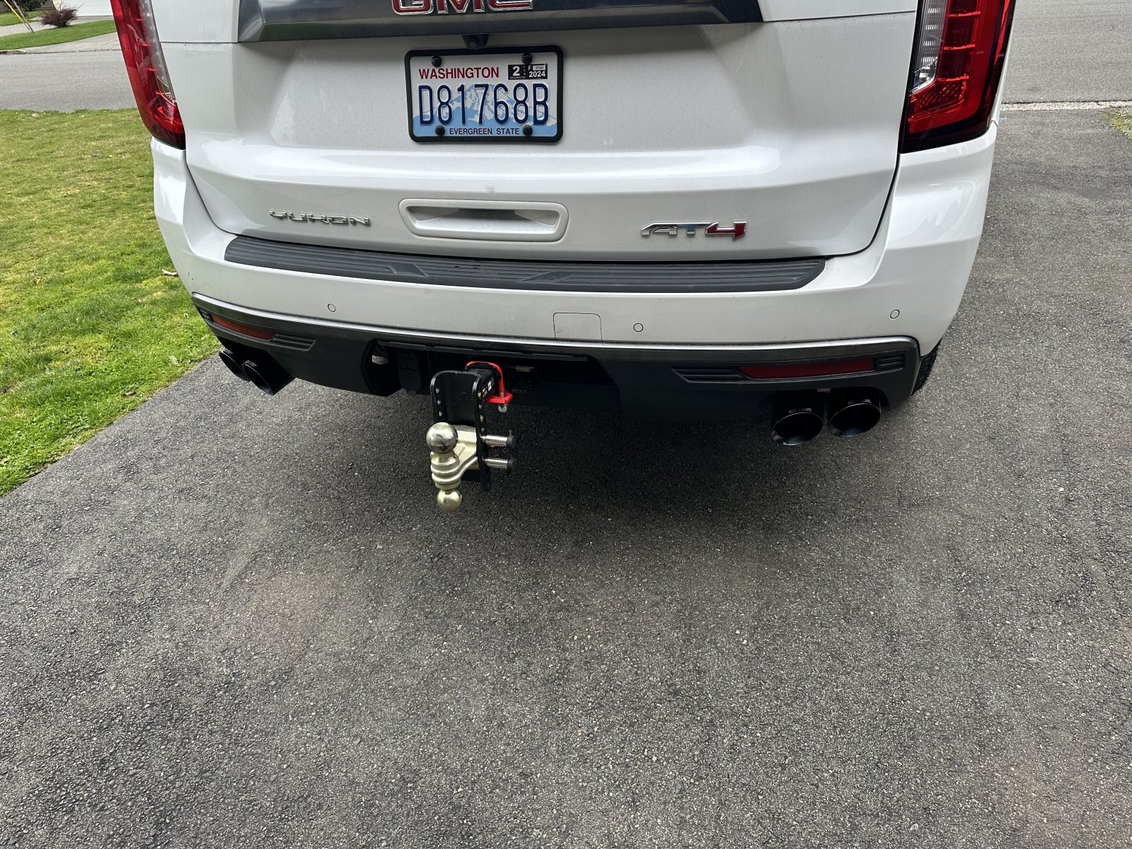

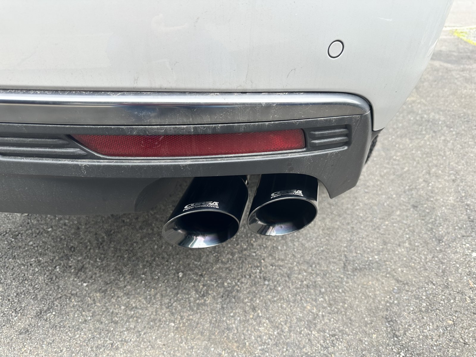

Well... I did the install this past Friday, no stands or ramps. It was tight on the side, especially trying to lift the muffler drum section into place, it slipped once, busted my lower lip... install battle wound. Were you able to torque to spec the clamp on the connection point above the rear suspension cross member? I wasn't able to get an angle torque it down so hand cranked down tight.
Did about 40 miles of driving, it's still burning off the oil residue (burning smell is strong) so I'm a bit paranoid about leaks.
I also noticed the rear tips do not align dead center in the rear facia cutouts, each side sits closer to the outside of the cutoff with a larger gap on the inside of each tip section. I'm guessing others are seeing this?
