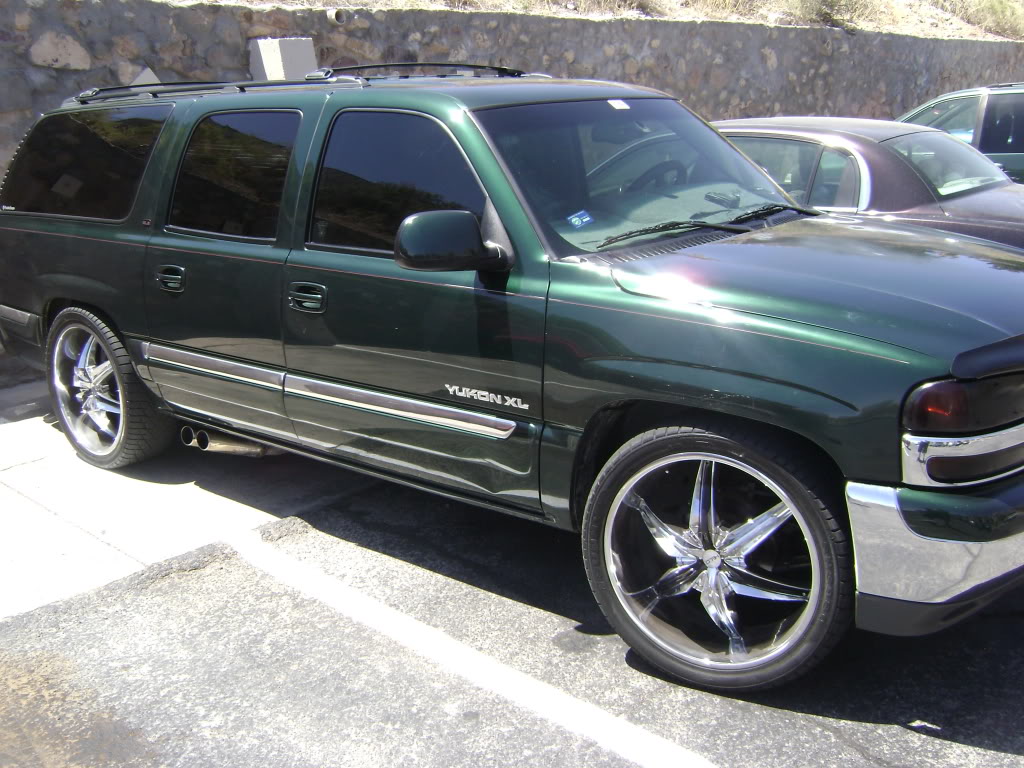

This would be ideal for me. I love this thing all the way around. Is this about the same effect I would get with that kit and what size wheels do you think these are??

that looks like stock height in front just taller tires and rear lowered.

yes front we can adjust the keys if needed then in rear I have a 2-3 inch kit where you can leave it at 2 inches now and if you go lower later you can pull the spacer out to give it 3 inches.

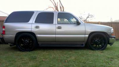

I say do at least the 2/3-4 kit. It'll close the wheel gap nicely but not like a static drop IMO.

22x9.5 with 285 45 22 would look good honestly. Needs a tall tire to fill up the fenderwells
