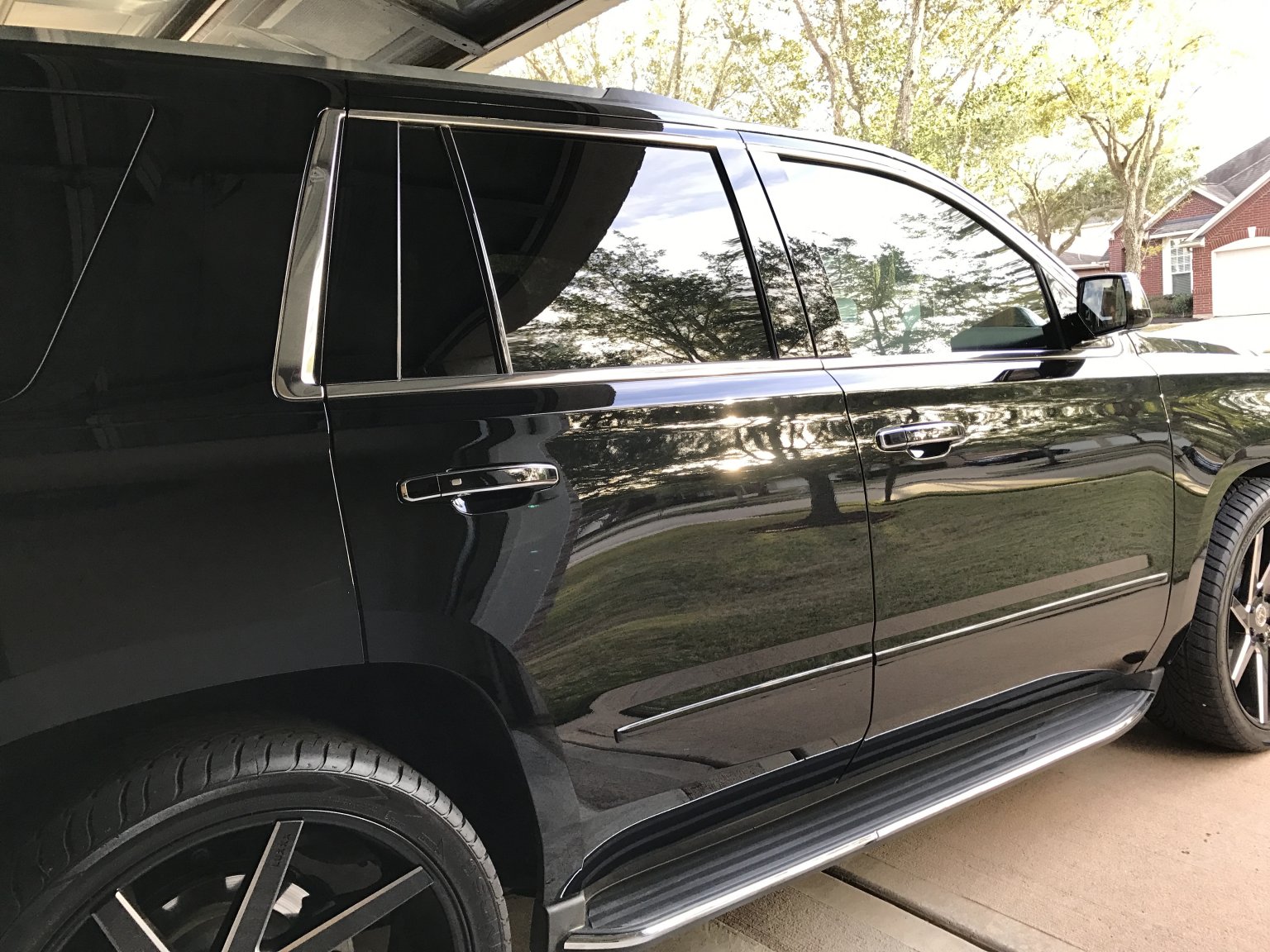

Wellllll.....I did it! Thanks for the confidence booster! Fortunately, I didn't have to use a heat gun/hair dryer. I just used dental floss. That was the easy part. The time-consuming part was the removal of adhesive/residue. I used goo gone and it worked okay...but later tried rubbing alcohol and that worked way better.
I only did the sides and removed the LTZs and the TAHOEs. I'll do the rear TAHOE tomorrow.
