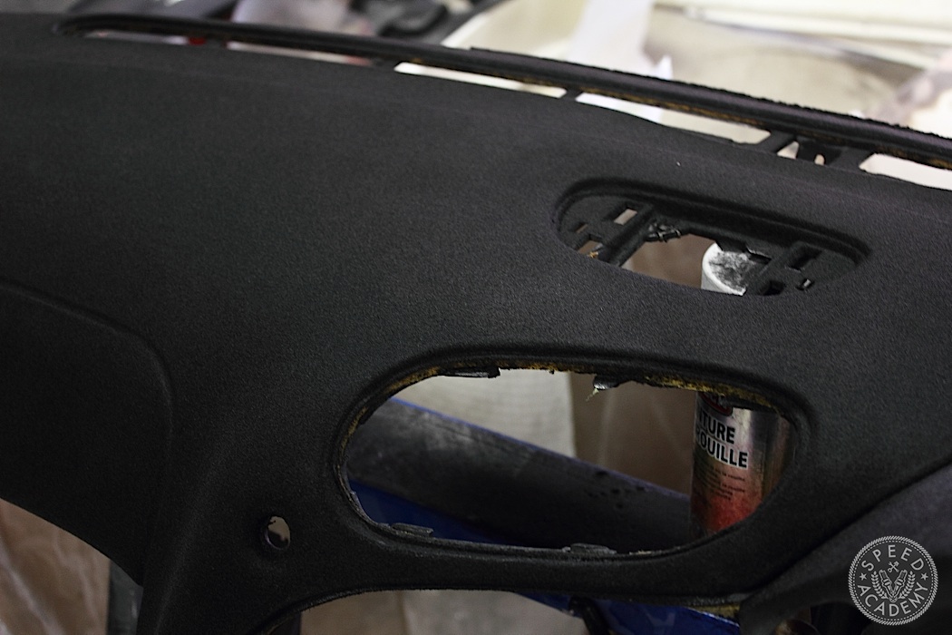

What's causing these cracks on relatively new vehicles? Sunlight? Would a dash cover have prevented this?
Large, unsupported area. The plastic being made brittle with age and/or exposure to UV and/or extreme temps exacerbates the issue. A dash cover may make it worse by holding heat under it. I've always told myself that if I had a dash that hadn't cracked yet, I'd slip a couple of gallon-sized or maybe 3 or 4 quart-sized Ziploc bags inside the middle of the dash under that big unsupported area and squirt some expanding foam sealant into them.
You know that would not be a bad idea really. There is so much empty space in there. I added some foam and such that only helps so much...
44,960
Your foam is probably doing just as well if it's placed in the right areas and if it stays put.
My thoughts with the expanding foam is that it would fill in and take the shape of the surrounding areas, securing it into place while forming a "custom-shaped support". Putting it in bags keeps it from sticking to everything (especially wire harnesses) should the dash ever need to be disassembled.

Expanding foam could too easily go too far and destroy your dash.
