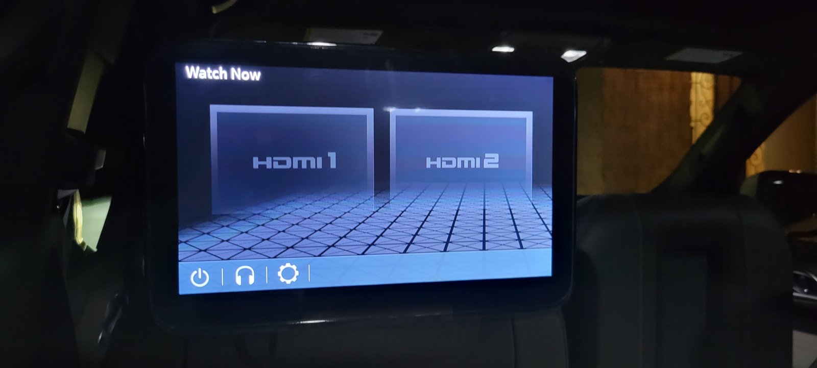

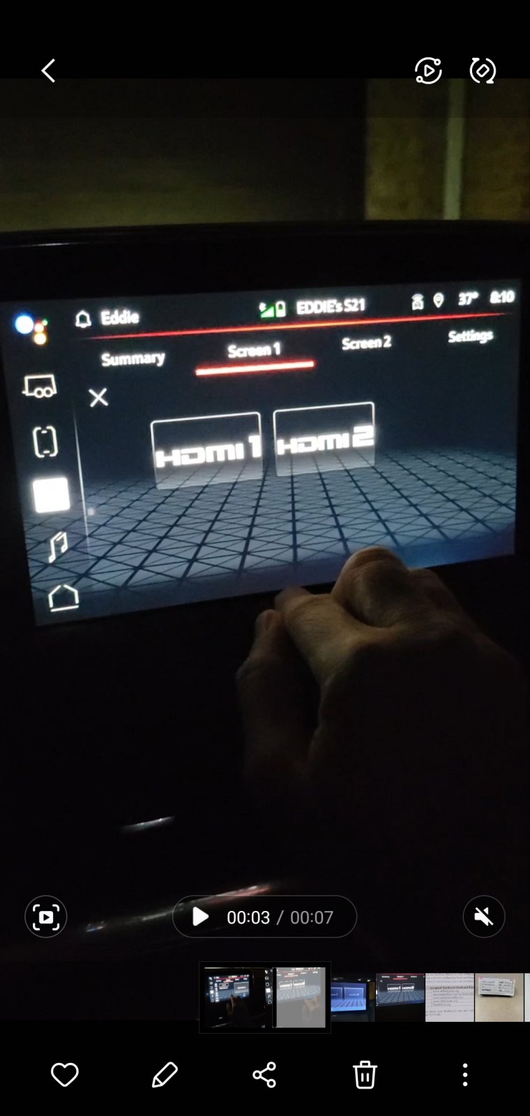

I received my 2022 Yukon SLT with rear entertainment package this week. (Ordered in August 3rd, delivered to dealership November 22nd)
The trucks interface completely changed to Google, and with that they removed critical features from the rear entertainment. They removed option for USB drive playback and miracast. I would like to know if they plan on bringing back these features in future android updates, right now it's running Android 10 June 2021 build date. There is an option to update software but this is the latest build.
I am using a USB drive attached to usb-c slot in the rear under the rear climate. It's the same USB drive that is working from my old 2017 Yukon, and I tested the drive on my galaxy s21 and it reads the files and plays videos fine, I need to know if there is a way to enable USB video playback, because using hdmi was not my plan for the rear. I wanted to be able to control the content with the front screen. And I'm very upset they crippled this option on the 2022 model year just to gain Google assistant interface.

I have the same issue, roku works great but my scandisk drive is useless. The usb c ports are just power right now… I even tried usb c to hdmi, no joy.

I was able to turn on developer options in settings and enabled usb debugging and will try using some adb commands, I am going to test which usb ports support usb drives, and then I'm going to force install some apps but that will not help me with the app the controls rear screens. Until GM adds usb file support to the rear app, I am p'ed off. I am most likely going to file a small claims suit against GM to get my money back for Rear Entertainment System.
