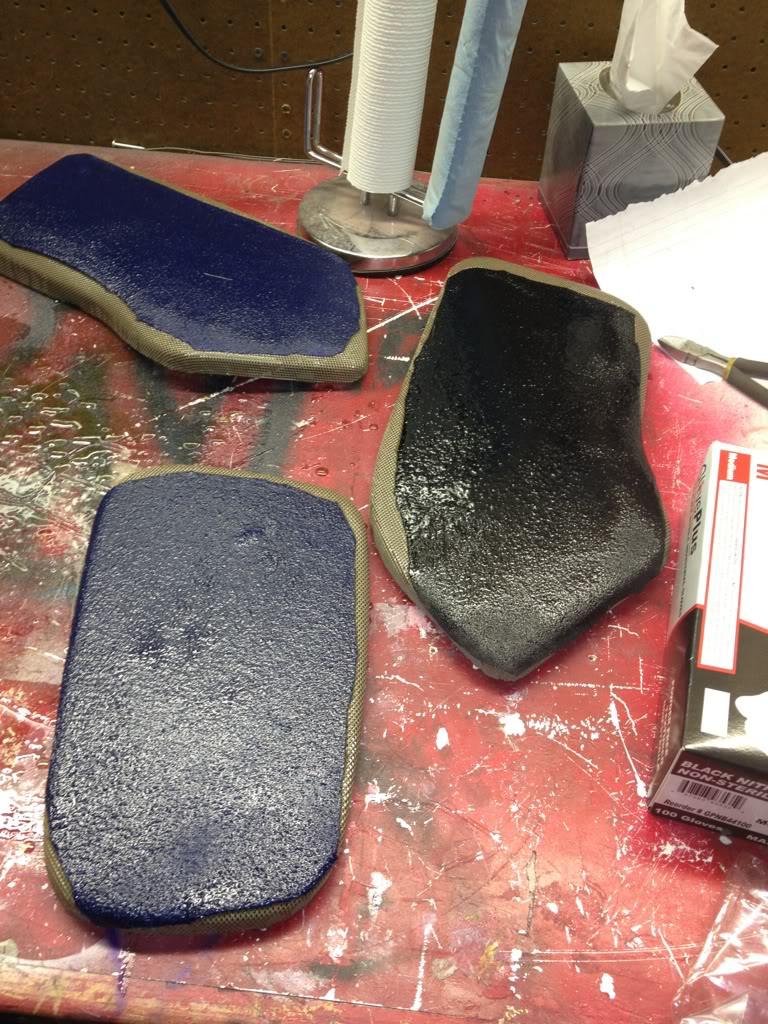

So I got started on my newest project which is going to be a big project but its going to be a lot of fun. I'm building fiberglassed speaker pods which will be home for some new Rockford components. The speaker pods will either be smoothed and painted black or wrapped in black suede. Haven't decided yet.
I'll try to remeber to take lots of pics of the build. But here's a few from todays progress.

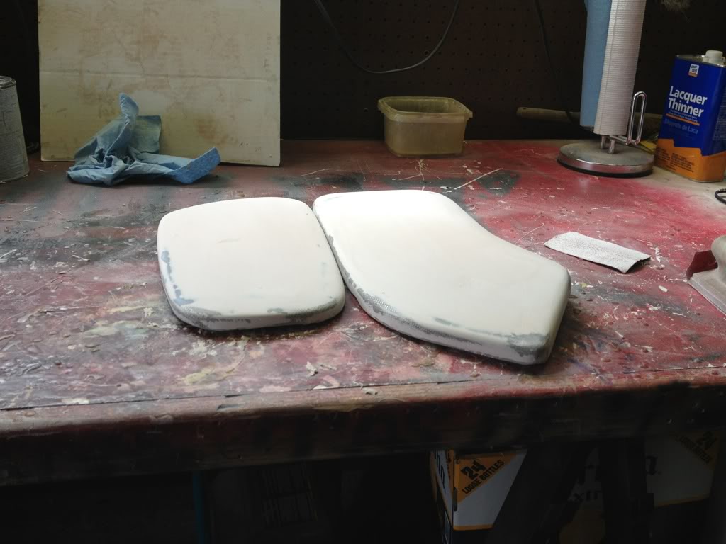

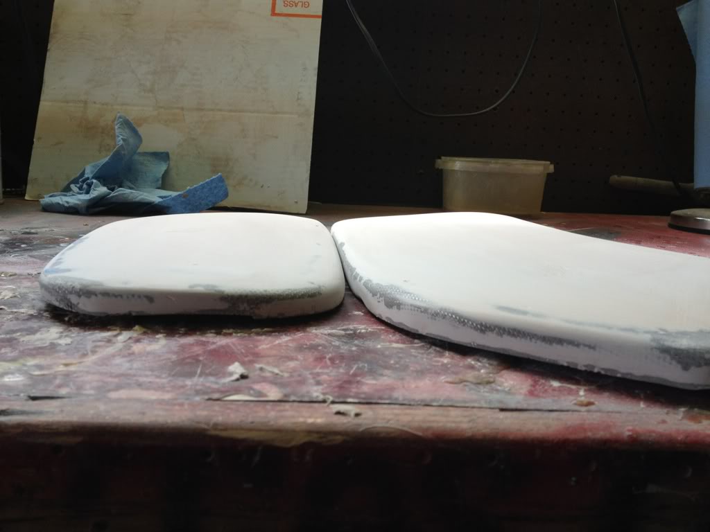

What I did was cut some cloth to cover the grills to give me a solid surface. I then coated the grills with resin, layed the cloth down and then poured more resin over the cloth (deff is a messy project). Tomorrow I'll be adding more layers on the inside and outside of the grills. Prolly won't put any fiberglass on the outside, only on the inside. Not sure yet.

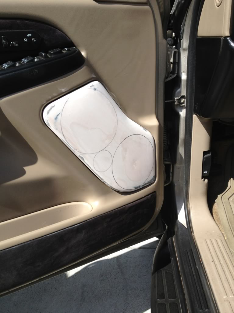

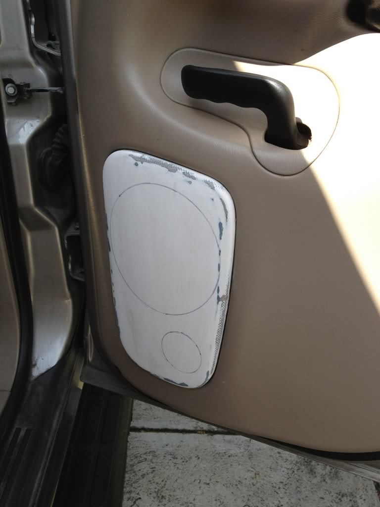

So I've made some good progress in the last cpl of days. I'm all done glassing and onto bondo to make things nice and smooth. And I decided I'm gonna wrap them in black suede leather. I did 2 layers on the outside of the grills and I did 3 layers on the inside of the grills so they should be strong. Doesn't look like much right now but it will look a lot better in the next cpl stages when I get some speakers and tweeters mocked up and start cutting some holes.

Don't usually venture from nnbs but this is going to look amazing!

Its coming out great should be real strong, nice job.
