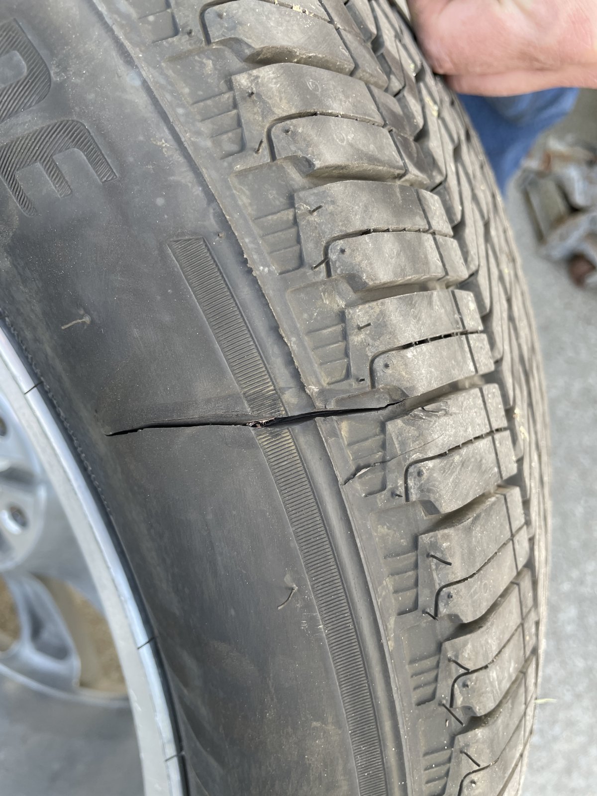

So, I got my new 2021 Tahoe Premiere about 2.5 weeks ago and took it on it's first road trip down to a friend's place about 60 miles away and when we were driving around that city, we parked somewhere and I could hear air coming out of one of my 22" tires.
We were next to Sam's Club so asked them if they could patch it quick...they checked it out and somehow the tire is split from the tread area through the sidewall. The tire lady there who looked at it seemed pretty knowledgeable, but made the comment she's never seen anything like this before on the inside of the tire.
These 22" tires are Bridgestone Alena 275 50 R22 tires which nobody seemed to have in-stock after calling around to 5 places in that larger community. We managed to get it back to his house where we put the spare tire on using his floor jack (as removing the spare tire on this 2021 is the same amount of fun it was on my 2007) and I had no issues driving it home. The sad part is I'm replacing a tire that looks like wil cost slightly more than $300 on a vehicle that currently has less than 600 miles on it. :)
I'm going to call my GM dealer on Monday and see if they can get one ordered/installed. My questions are with this being a full-size spare tire (even though the spare is 17"), I'm assuming that I can drive on it without issue for a few days or up to a week since it's a regular tire? Also, I'm including a photo of the gash on the inside of the tire...curious if anyone else has seen this with their 22" Bridgestone tires. I'm guessing there's no road hazard or any type of warranty on these tires unless it's deemed a defect, correct?

if you have onstar it may include road hazard, talk to onstar or your dealer

Sorry to see that damage. On page 8 of the limited warranty booklet that came with the 2021 Tahoe it clearly states that road hazard damage is not covered. On new vehicles I always go to Discount Tires and buy road hazard insurance on all 4 tires. The Bridgestone Alenza 275/50 R22 111T tires go for about $260, Road hazard on all 4 was $192 including tax. Well worth it. On other vehicles I've used it several times and it saved me hundreds.

100% I've had tires slashed before. They looked just like this.

Sorry to say that’s NOT a cut from someone That’s a road hazard try cutting a tire sounds easy, I managed a tire store for many years try slashing/cutting a tire on the inside never happen ROAD HAZZARD..

Oddly enough, many years ago on my 2007, I had nearly identical occur. Except my “cut” went in the opposite direction, as if it continued it would have been circular like the tire. Enormous gash, 10-12”. Rear driver side, inside. Mechanic said he’d never seen it happen before, would have expected the front tire to be damaged. There was no visible road hazard. Due to the size, tire immediately flattened as I had been at a red light when it occurred.
I’d press your dealership to replace by saying you are rethinking your purchase because there was no road hazard and the location is bizarre. $300 to ease a buyers mind is good PR. They want you to return, buying another, when that one ages.
