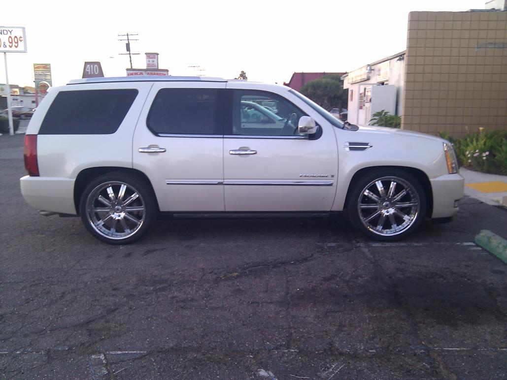

Jun 13, 2010
41
I have 3/4 drop with 24s no rubbing at all, but when I had my past 07 Tahoe it rubbed alot because I bought cast wheels with generic not specfic offsets (close but not perfect offset).
