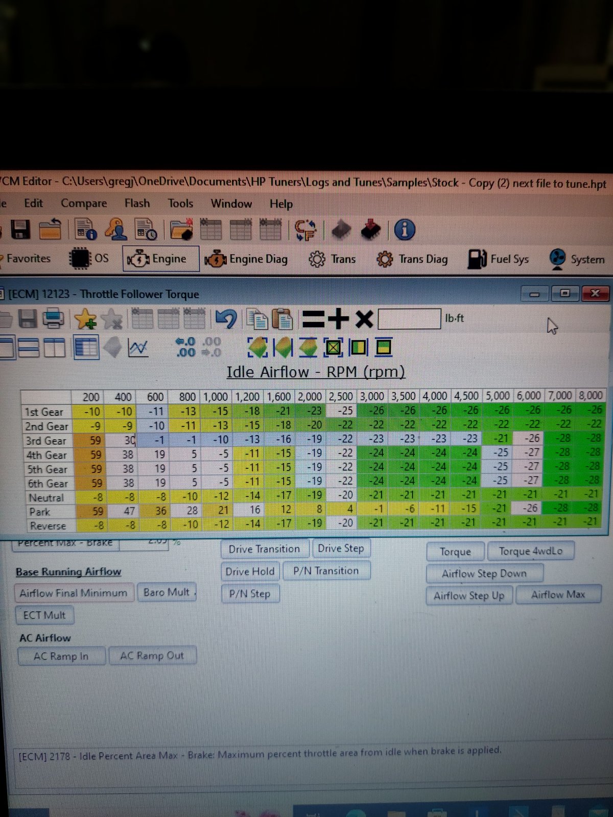

Tuned the ECM/ECU using HpTuners MPVI3 and my laptop computer.
How do you tune that??? And what was it doing before tuning?
And what year 5.3? Your stock values look different than mine.
I keep hearing about people tuning their VVE or running speed density.
I think I'm too scared and lazy to do that.. unless it's sooo much better?
Diablo tuners would not do what I needed most, adjust idle, so I got HPtuners MPVI3. It allows you to adjust spark timing, throttle response, transmission shift points, air intake, - name it. Im still blown away with what it allows you to tune. You can make a regular engine into a different animal. Highly reccomend.

Sure is fun (and overwhelming!) looking at all the tables and variables.
I have been working on a transmission tune, and I'm quite happy with it just for daily driving compared to stock.
Mostly shift scheduling, I highly recommend the 2015 shift schedule as a starting point.
..currently trying to figure out what 'desired output torque factor' does..
But how do you determine how to tune the throttle follower?
Are you logging airflow/throttle position/torque output or something, or is it by feel?
And, why is 3rd gear so different from the rest? (which looks like you tweaked to be inline with the other gears)
