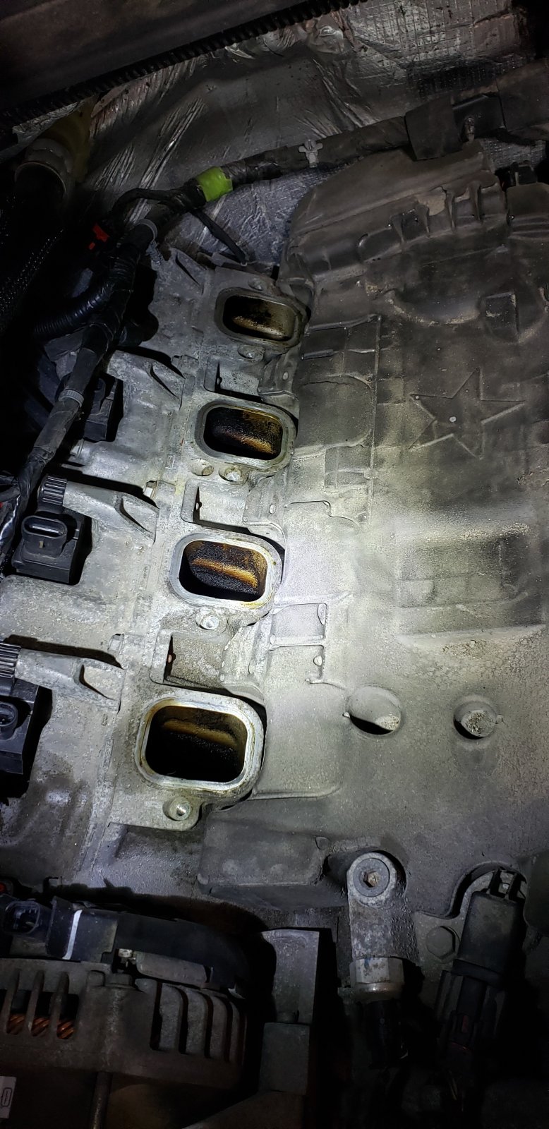

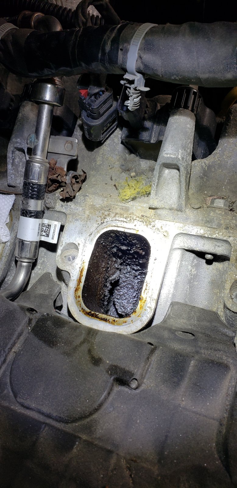

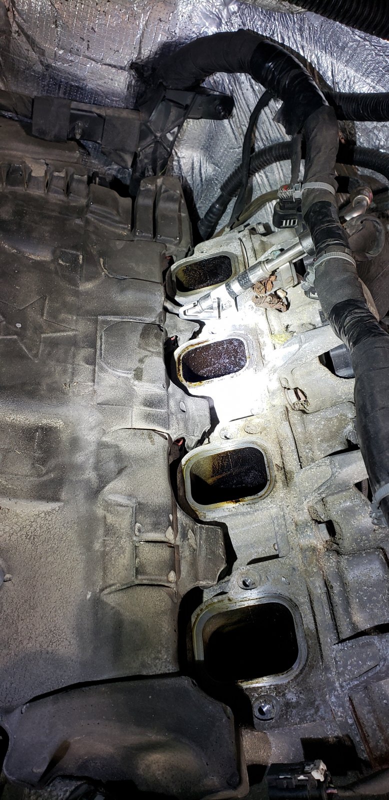

Hi all,
Please see attached pictures. They're all dirty. Cylinder 5 is the worse. It looks like the bottom of a dirty grill.
1. Is there a way to clean this? I could scrap and vacuum from the top but I worry about something falling into the head.
2. What causes this? Bad PCVs?

You should install a oil catch can, it will prevent this. There are methods to clean out the gunk but unless its really bugging you, add some fuel treatment to a few tank fills and it will help it disperse. I personally like Marvel Mystery oil and add it to a tank every few months. You don't really want to spray anything on this area as too much could wash the oil off the cylinder walls and rings.
BigNorm4Life
Aug 14, 2021
yeah... it doesn't look that bad.... I would spray the fuel treatment all in that and drive the PISS out of it on the highway for a gas tank or two

Direct injection engine? Adding stuff to your fuel tank won't do anything since the fuel is injected after the valves. This is why the DI engines (of all makes) build up carbon. As THarber mentioned, a good catch can to reduce the oil going into the intake manifold would be big help. As for cleaning, it's pretty much a manual job at this point and walnut blasting is the common method. Have it professionally cleaned then maintain it with regular doses (Monthly? Bi-monthly?) of cleaners introduced through the PCV hose. CRC Intake Valve & Turbo Cleaner is a good one, but there are others. Look for solvents with PolyEther Amine (PEA).
You don't wanna break up that stuff and let it go into the cylinders. Small chunks likely won't do anything, but they could still all end up impacted in the cat converters and eventually clog them. You need to dissolve, break away and remove the carbon out from the port.

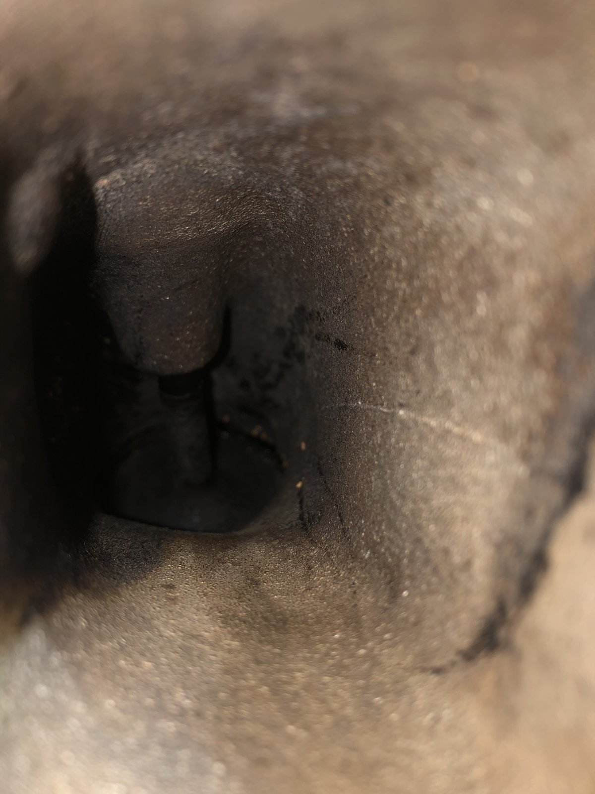

I just cleaned my valves. Tape off every port except the one your cleaning, turn the engine by hand to close the valve, and blast it with walnuts using a abrasive air gun. When your done blasting blow it all out with compressed air. Here’s after.

Yeah I tried a rag and carb cleaner first. I gave up and went to harbor freight and got a cheap blaster for $30 and 20lb of crushed walnuts for $20. Best $50 I spent!

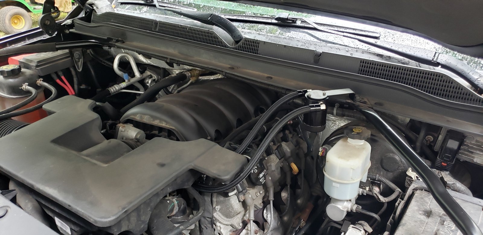

That's what I put on mine. Make sure you get the right one. The one you referenced is for a truck, not SUV and there is a difference, ask me how I know...LOL. Its a 15 min install.
