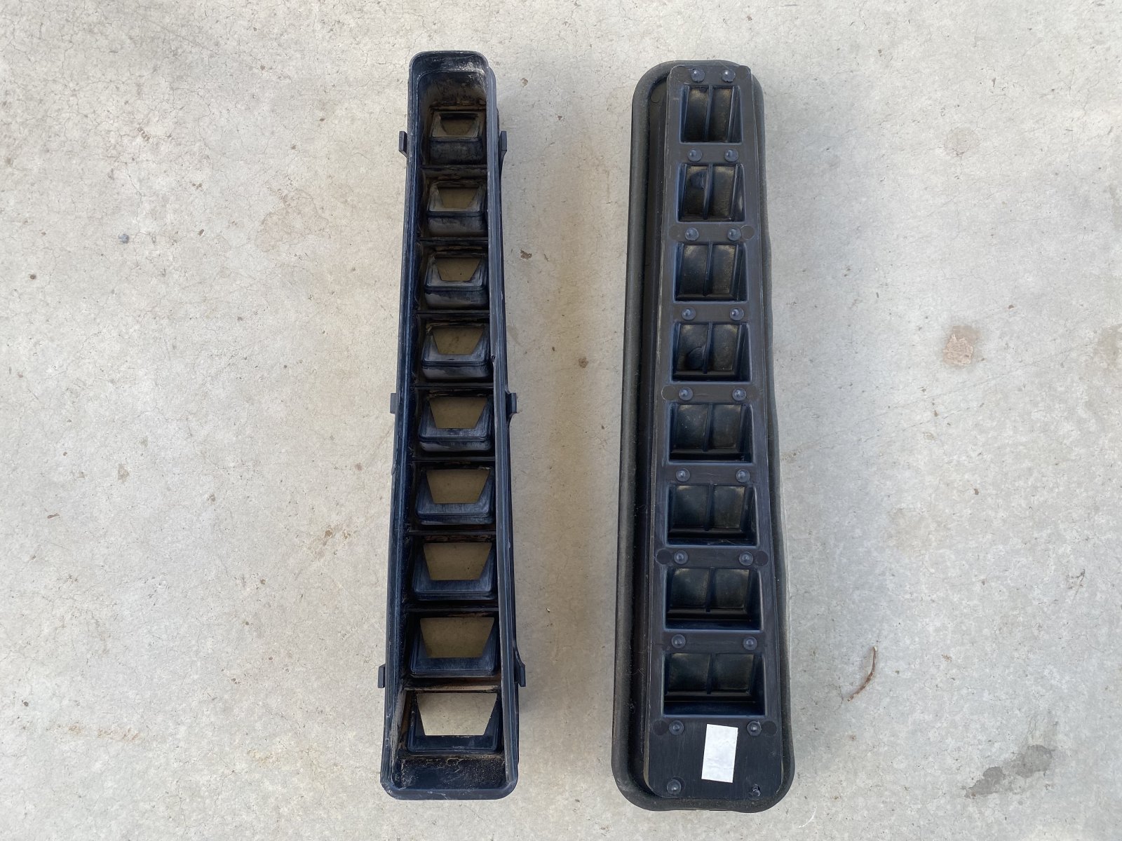

Can't find the correct name for these anywhere. I'm not looking for the exterior cover, I'm looking for the piece that goes under them.
Black plastic thing with little rubber flaps to release cabin pressure or something. Mine are missing several of the flaps and I occasionally have to travel on gravel. The entire truck fills up with dust because these stupid things obviously don't seal correctly with missing parts/rubber flaps. Anyone know a part number or the correct name for them?
Thanks!!
I need to replace the drivers side also and ordered two used OEM ones from eBay for $ 14.00 but they are called "Pressure Relief Valves"
New Part # GM 15816854
Old Part # GM 15756444
opfor2
Mar 29, 2023
280
219
Riverside County, CA
Good morning, all, so I received my two "body Pressure relief" valves from a seller on eBay yesterday (GM 15756444) and went to replace the old ones and noticed that the ones that were presently installed in my 2011 be very different (see picture old on the left and new on the right) The old ones have NO rubber valve flaps installed while the new ones did. Just kind of weird and this would explain my dust intrusion into the rear of the truck.
