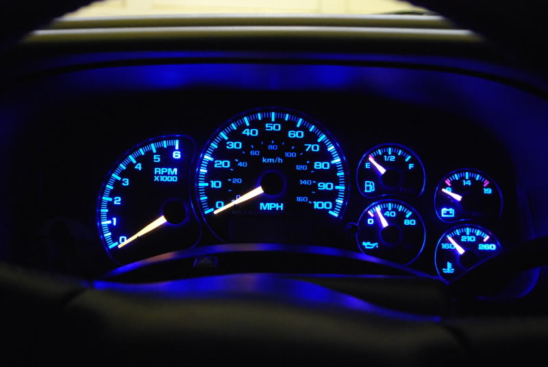

tilghman
Nov 1, 2009
25
Fayetteville Arkansas
These are with blue leds correct?
Here's a couple of mine:
these are blue corrdct?..has anyone done this mod with clear?
I have the WHITE LED's and they look like a very light baby blue just like this picture. They won't look pure white for some reason. I think the stock bezel has something to do with it.
Here is mine: (Excuse the iPhone Pic)
