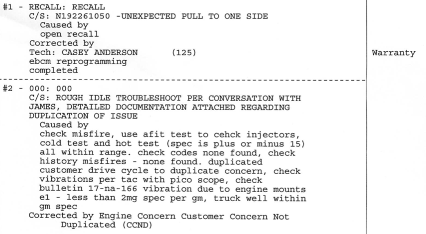

For the "fun" of it, GM keeps replying with the same canned replies, but this time from their so called escalation email [email protected] but note it is the same person writing who responded earlier with exact same statement. I will trying calling now but from reading, call center will not overrule what email support did...
For $50K, I am jumping through all the hoops and getting nowhere. If there is a good advice on the attorneys, I think I would. Small court does appear to be an option here.

Good morning. Please know, both GM and Hendrick dealership thoroughly reviewed and exhausted all resources available to resolve the concern with your vehicle. It was determined your vehicle is operating as designed. I understand this is not the outcome you were expecting and apologize for any inconvenience this has caused. If you have any other questions or concerns about this matter, we strongly encourage you to continue working with your dealership.
