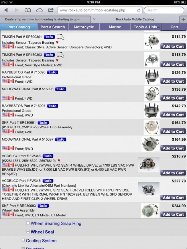

you can get timken hubs for under $125 all day long on amazon/rockauto and they are FAR superior to even the gm/acdelco wheel bearing.
serpentine belt is a SUPER easy replacement. under $30 for ac delco and a 15mm socket and a breaker bar to hold down the tensioner to remove and replace.

Ac Delco is GM house brand, $200+ online. Also IMO a hub or wheel bearing is either good or bad. Not "starting to go". How do they define that? If you replace, you should do in pairs.
