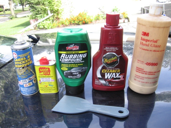

goo gone sucked when I tried to use it. I ended up using goof off and a spray can of adhesive remover. Spray the glue and let it sit for a minute or 2 then pour the goof off on a rag and wipe with your fingertip. everything I tried took way too long.
here was my kit that I used, the rubbing compound worked incredibly!
