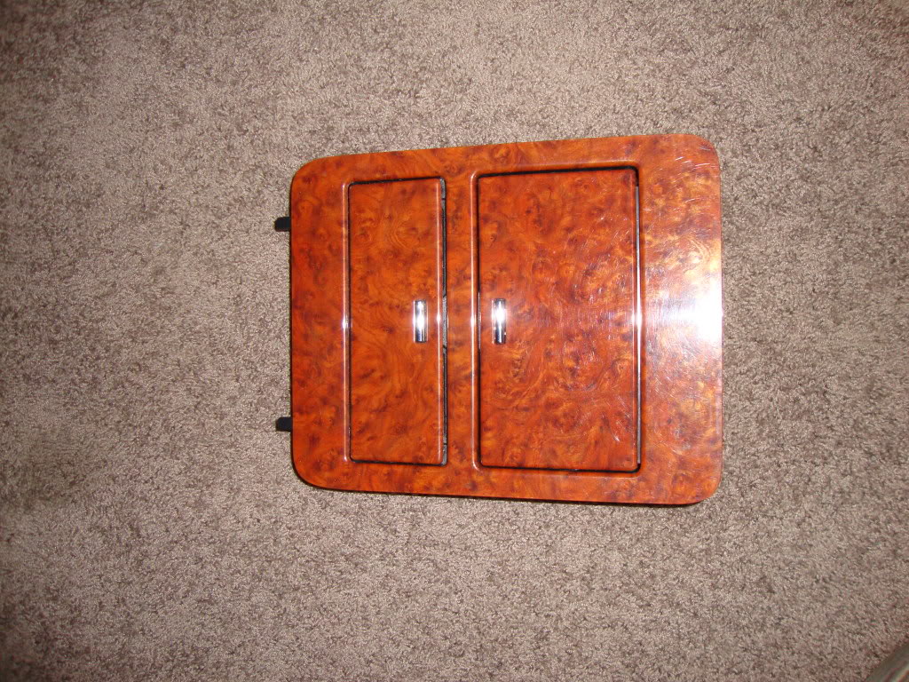

I recently had my Denali in the shop and had an SLT as a loaner. I like the cupholder setup in the SLT much better. The Denali has fold over lids that waste a bunch of storage space whereas the SLT has a large opening with cupholder inserts (and others, I'd guess). Does anyone now how easy it would be to pop it out? Does anyone know the p/n's for this?

This picture seems to show the Denali style, but I want the SLT version.

I purchased a set from someone here on the Forum with the intent of swapping out my Denali setup to the LT setup. I too, prefer the open tray to the flip up compartments.
It's still in the box and I've put the project on hold, so if you are interested, PM me.

Nathan, has anyone done pictures of popping these out?
the LTZ deal is beyond useless.
just pull up on the back of the cup holder area and then it slides up and back
done deal. my wife cant find a way to get her junk in arms reach.
Ok, will try it when I get the parts from Parthery
