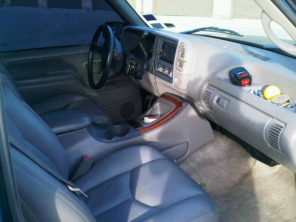

Did anybody here swap a 99/00 OBS Escalade or Denali console with the cd changer in a regular Tahoe ?

can't remember the site that made me do mine just pay attention when you take it out the other truck you can't use any of the bose stuff in that console except the sub a(BONUS)
You will need to drill 2 holes for front screws and flip the rear bracket around also you will
need to dismantel the console to get the amp ,cd changer and wiring to loose that extra weight in that console not mention to repaint the console. what year is yours ? i have the 4x4 in the floor so i had to to a little more work for mine to fit.

Thanks for the link . Mine is a 2000 OBS z71 push button 4x4
