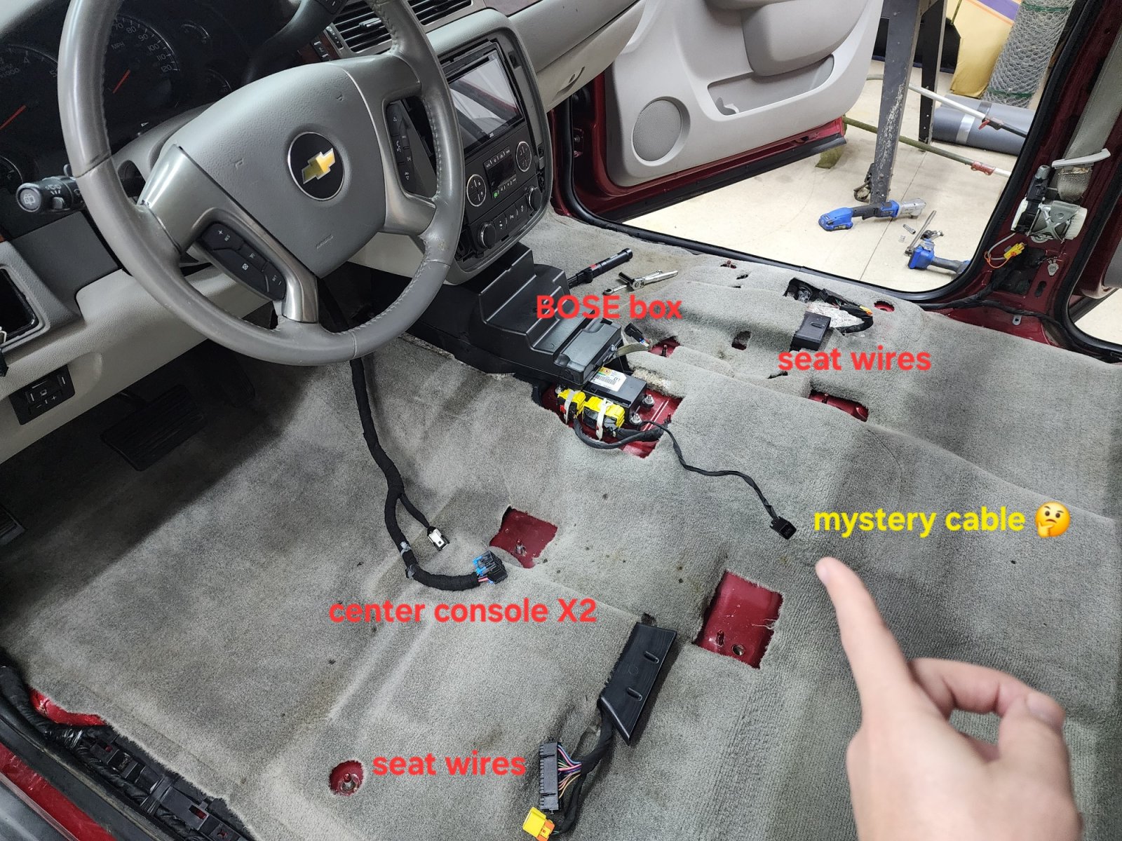

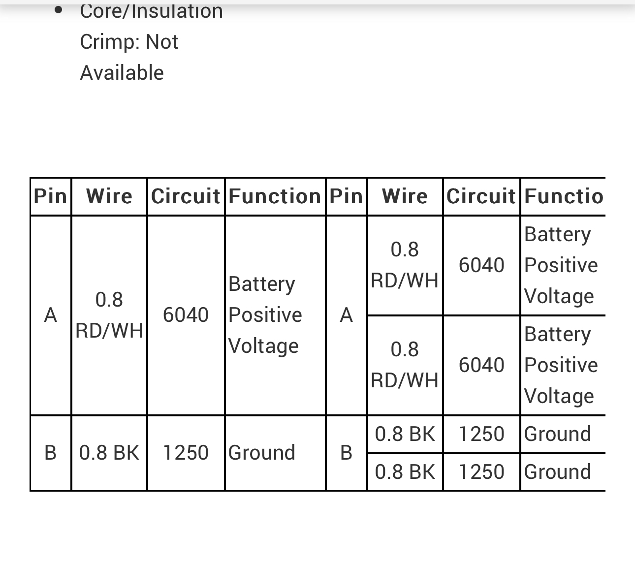

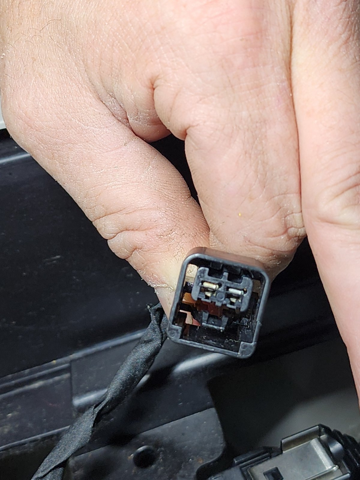

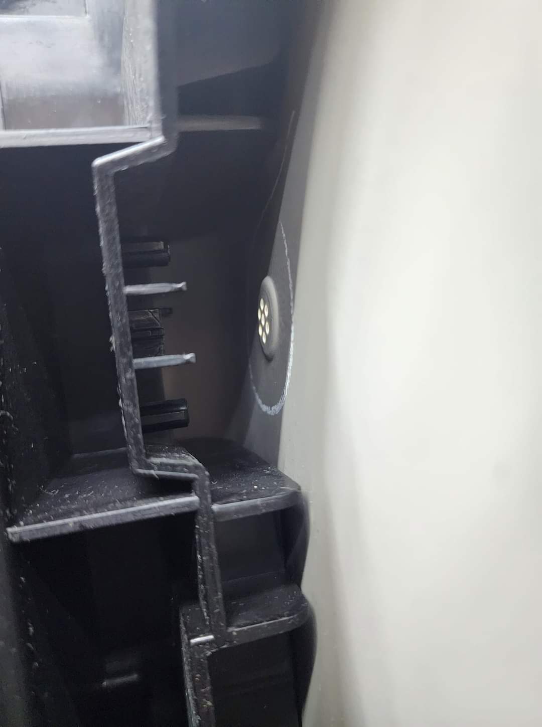

Do you know what module it plugs into? We have the one that is from the wiring harness. We cannot figure out where it is supposed to go. We think it might be here but are not certain.

Most of the harnesses are the same regardless of options otherwise GM would have to make 10 different harnesses for every product line. So not every plug on every harness in every vehicle is used. It might be for an option your vehicle doesn’t have. We tend not to notice an unused plug when we are disassembling something unless we label every single one as we are working because as soon as you unplug something there’s a plug not being used.

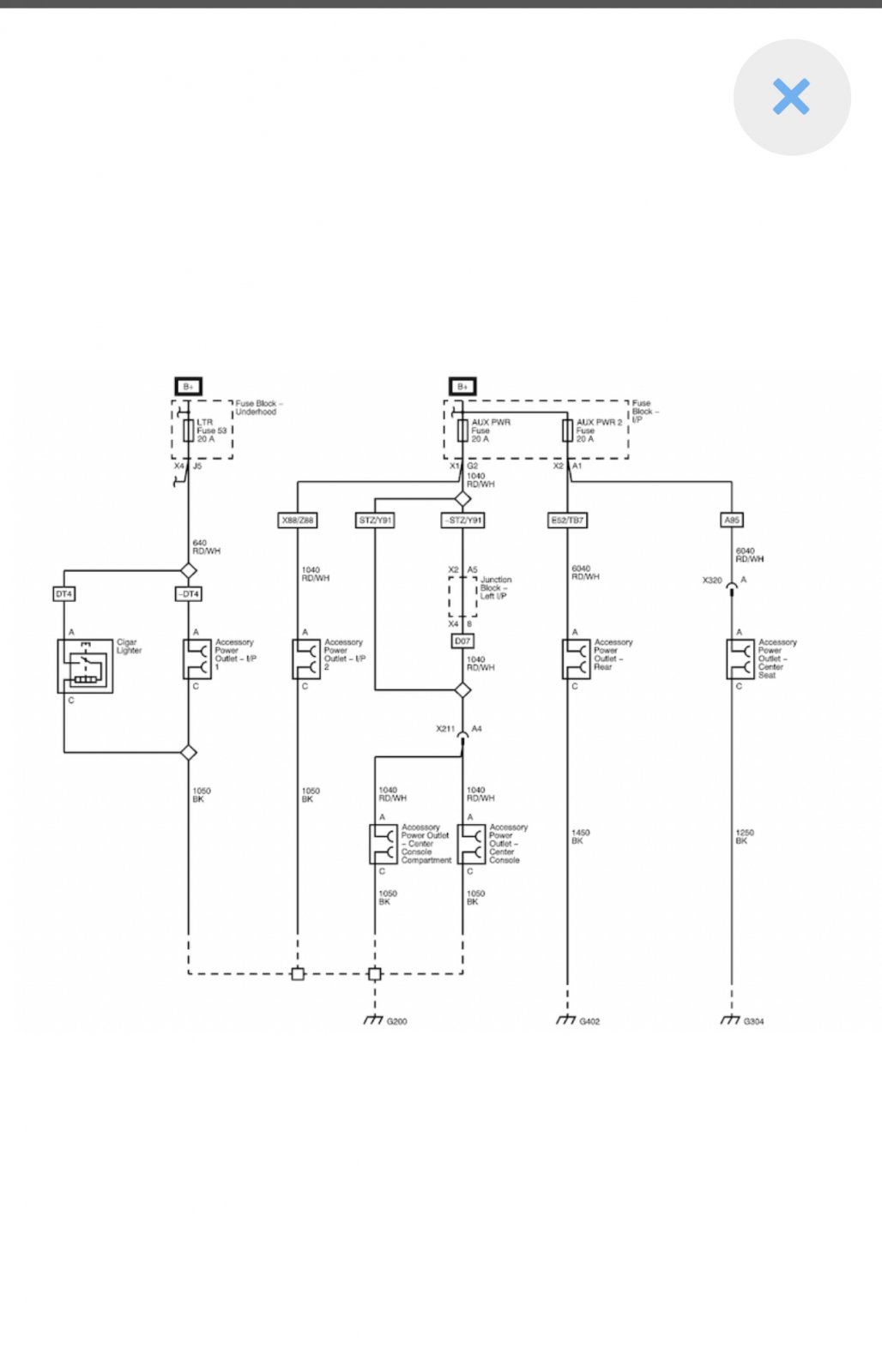

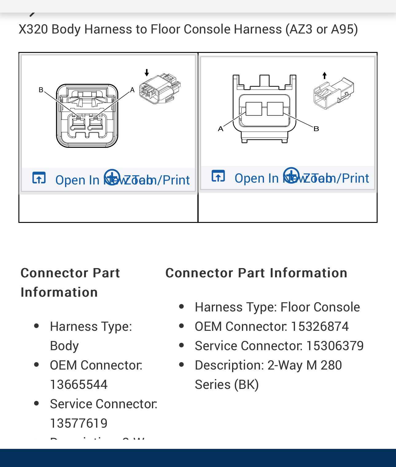

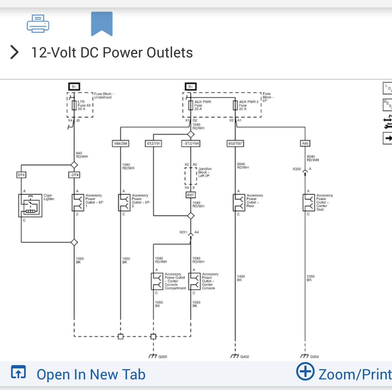

Maybe center seat power outlet in the diagrams?
See if removing AUX PWR 2 fuse on left side of dash cuts power to it..
