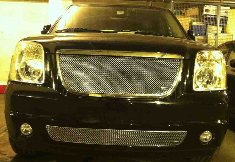

I've attached one pic from my mobile and will put more in when I'm done. I needed to make an adjustment to the lower grille but this will give you an idea.
I've also attached what the lower grille pieces look like so you have an idea of what and where the clips are.
