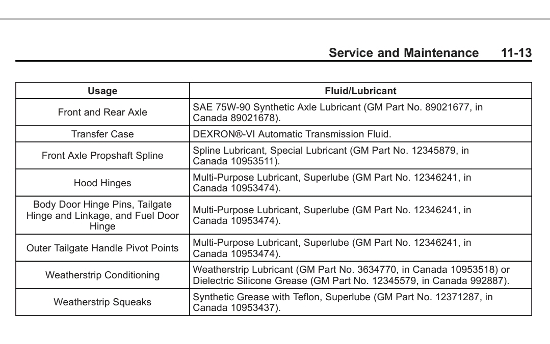

My 2019 Yukon's owners manual calls for 75W-90 in the front and 75W-85 in the rear. Can you use either of these weights in both the front and the rear? Probably!
