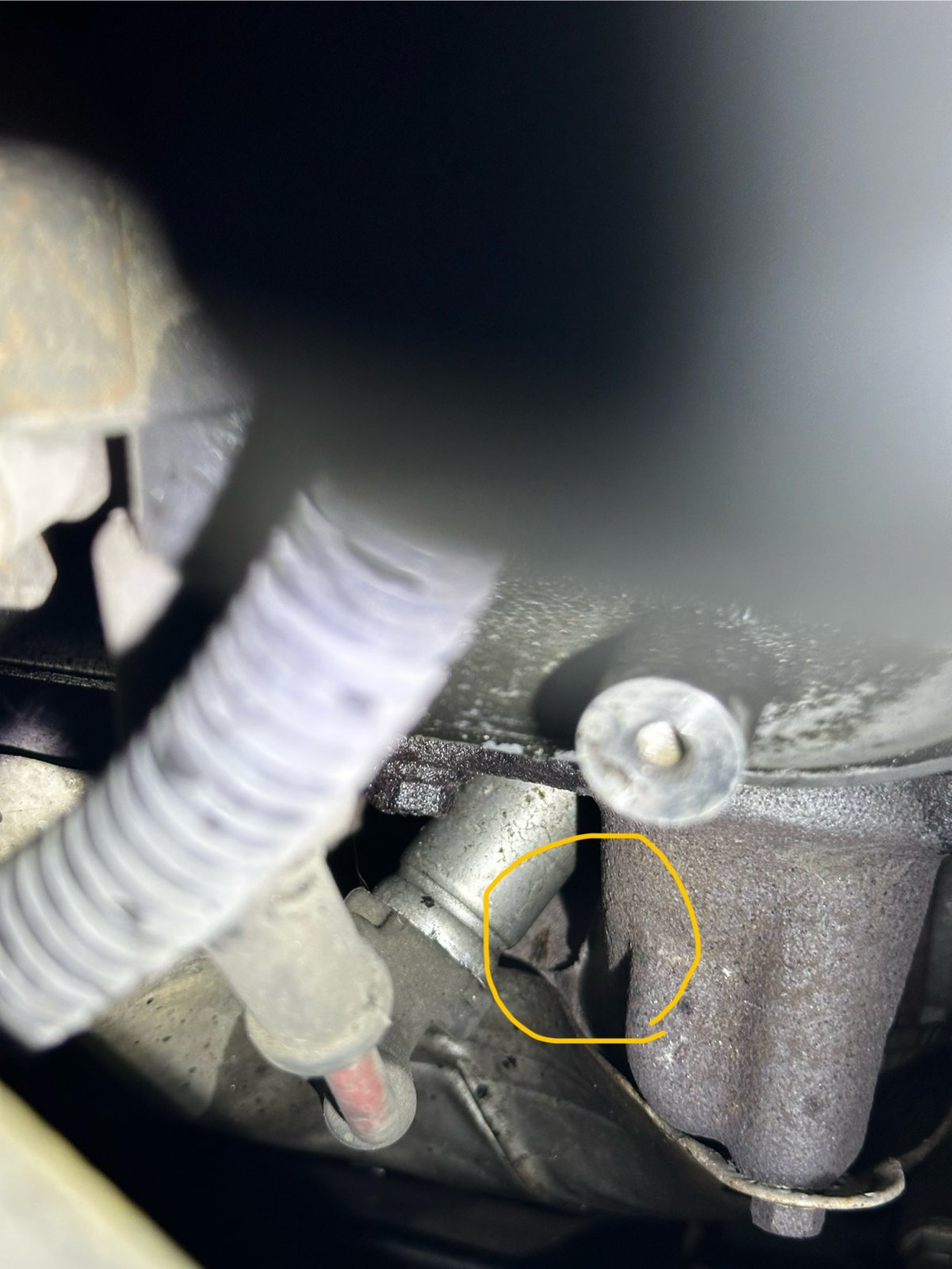

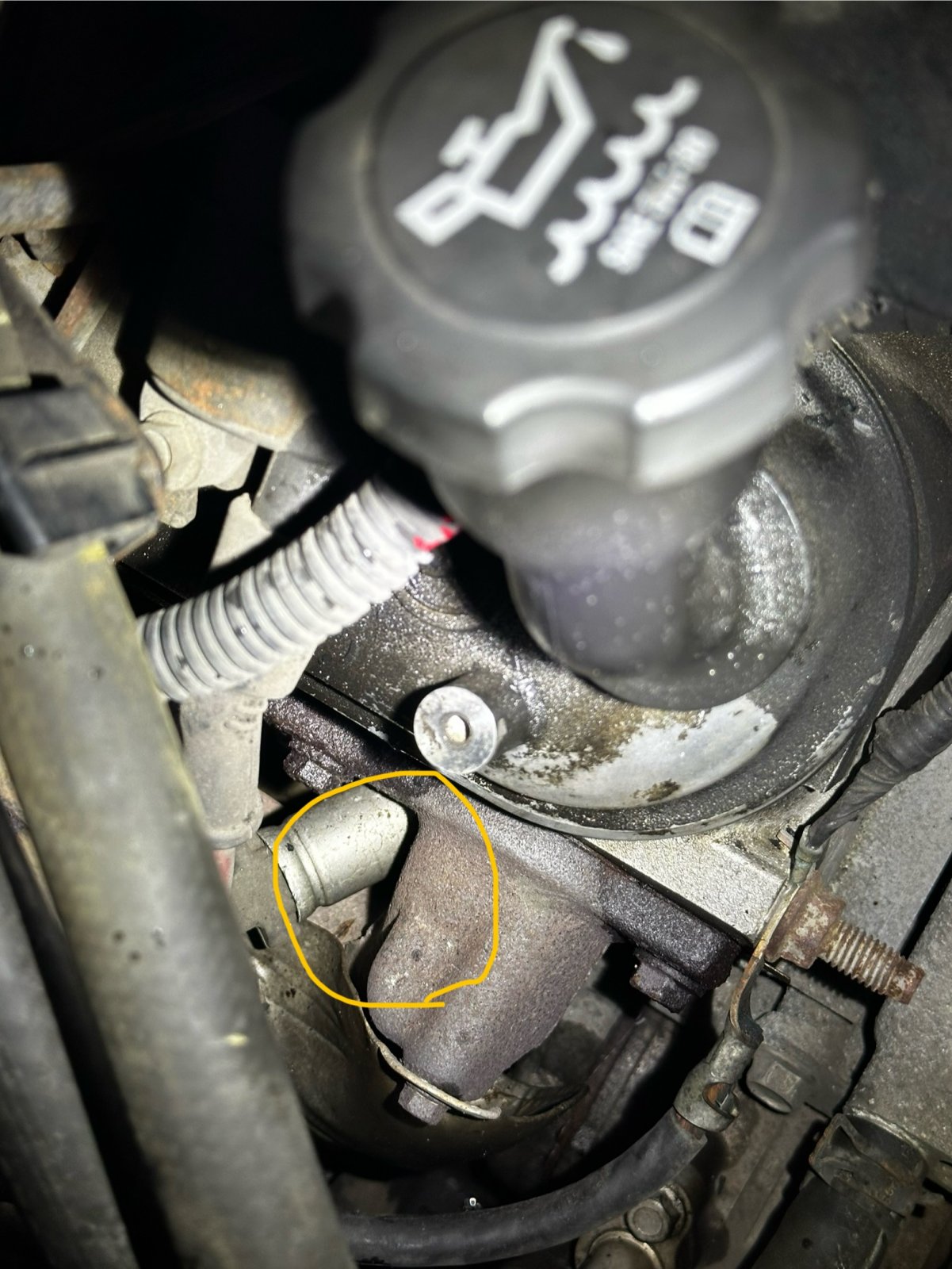

Wife and family smelled a weird burning smell in the cabin yesterday. Said it was very strong. I wasn’t home but a friend checked the oil and the dipstick was totally dry. They put in 5 qts of oil but the dipstick still reads dry. I got home this morning to take a look and make sure everything was fine and the dipstick is 100% dry. Literally not even a film on it after multiple checks. Any idea what could be going on? We have a small oil leak but nothing that would cause something like this to happen.

Is there a huge puddle of oil on the ground under the engine? (I kid, but you know.....)
Is the dipstick tip broken?
Is the dipstick tube broken where it sticks into the block, causing the dipstick to not going into the block/oilpan?
Try cracking open the drainplug for a half-second to ensure there's oil in there. It's not like the oil just teleported to Dimension-X.
