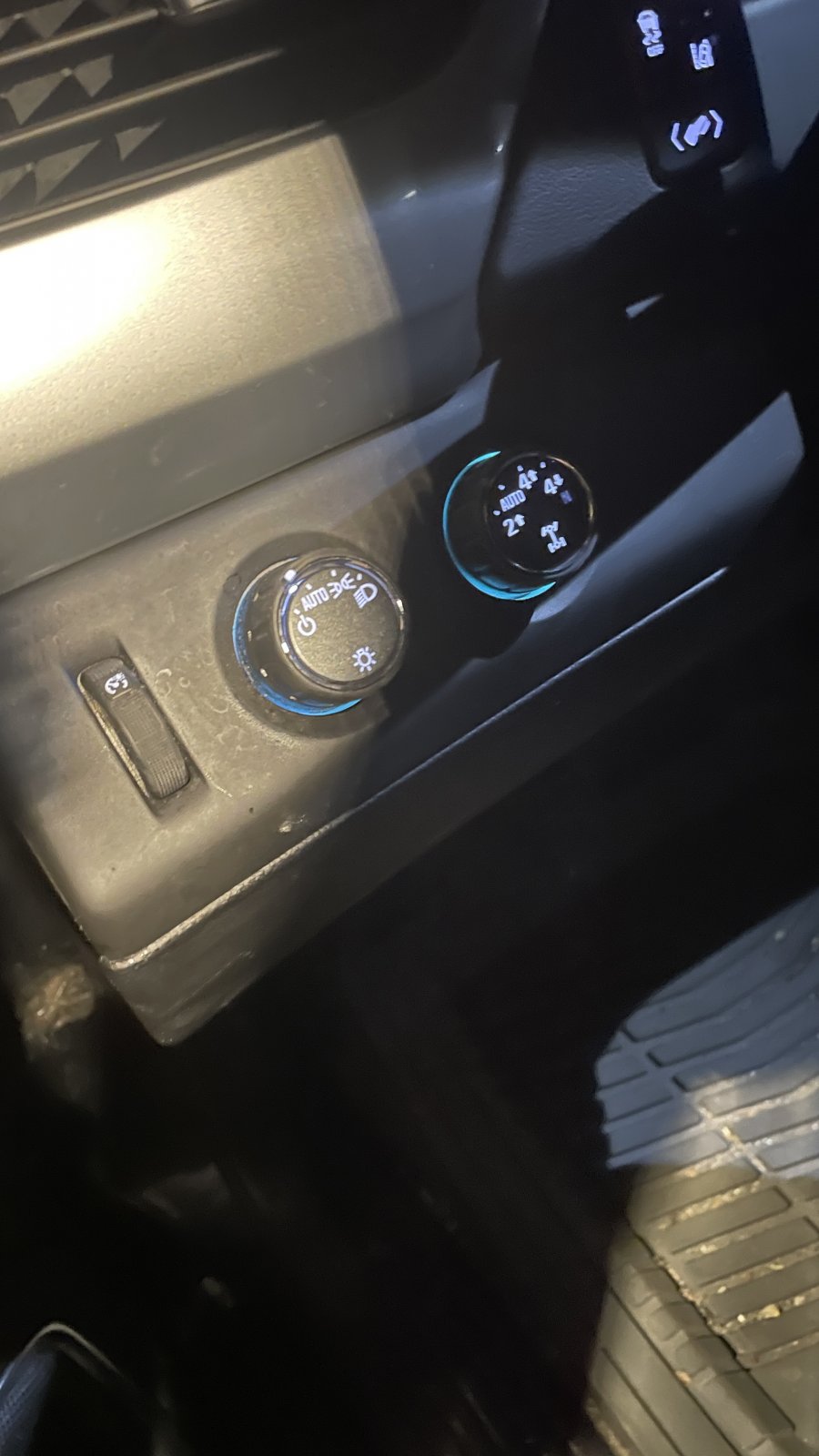

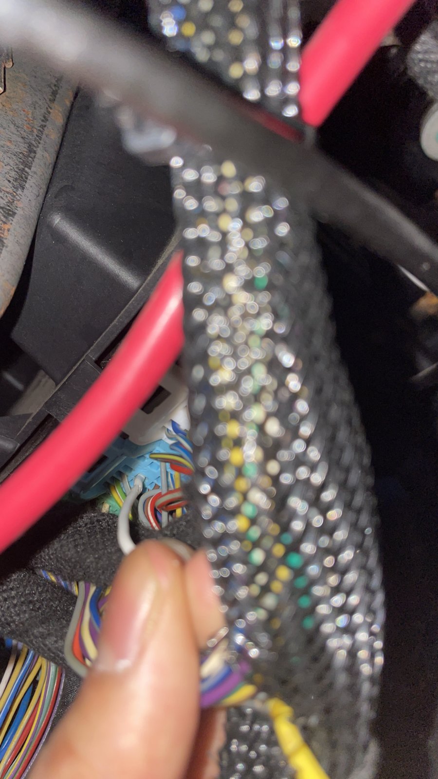

How did you figure out you have a seo 9g8? I have the same car as yours it was a K9 tho so ssv but going through the same issue of daytime running lights.
If you were able to figure out please let me know. My headlight knob says it has AUTO so hopefully I can enable them. I did check my BCM there is a white terminated wire in one of the sky blue slots and it’s not connected so not sure what’s the issue.

Just used deduction to assume I had the option enabled from the upfitter. Me and my step-dad replaced switches, did wiring, and everything you could do to fix the issue. Nothing worked, so when I stumped upon 9G8 it just made sense. Never was able to get them back on, pretty sure step-dad ended up selling the Tahoe without them or took it to a dealer to get them reenabled (I was out of town, don’t really remember)
