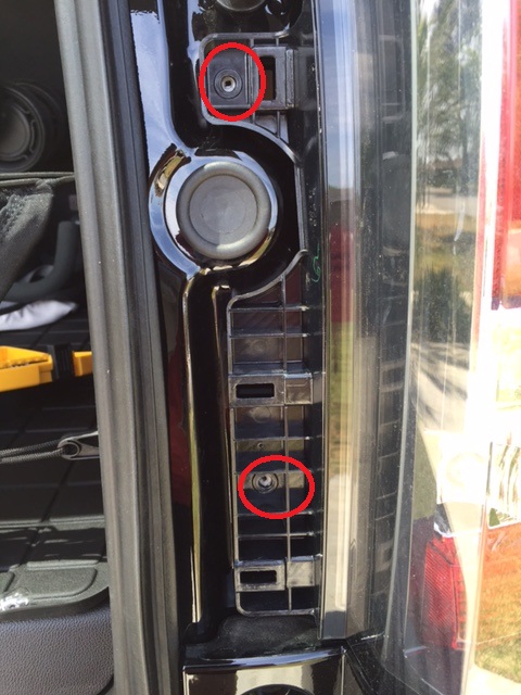

I was able to stick my finger in the corner and pry the plastic piece off. There are three tabs holding the plastic piece together. Be gentle but pull firmly.
Here is a shot with the plastic piece off. You'll need the star bit to remove two screws (circled with no screws)

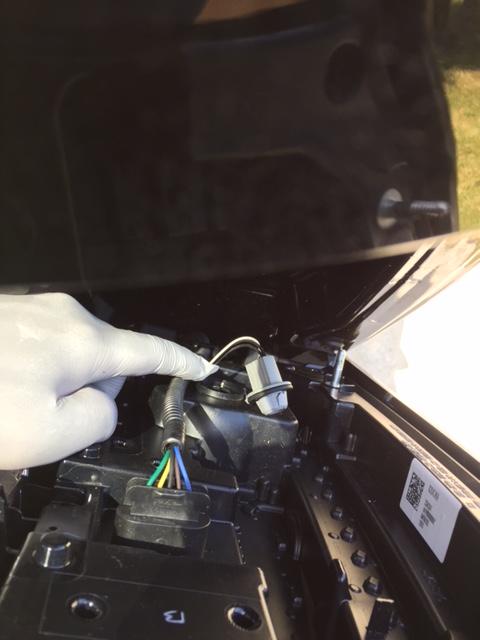

Unplugging the wire harness is not necessary. Twist the grey connector and pull the bulb. Insert the LED plug and check to make sure its working before you reinstall. If it doesn't work, pull the plug and reinsert the bulb the opposite way.

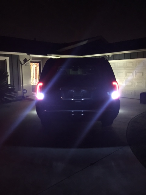

Finished product:

They are much brighter than stock. I used the same bulbs for both the reverse and license plate. The license plate lights are much dimmer. I suppose its due to the actual light housing. Looks better than stock either way.
