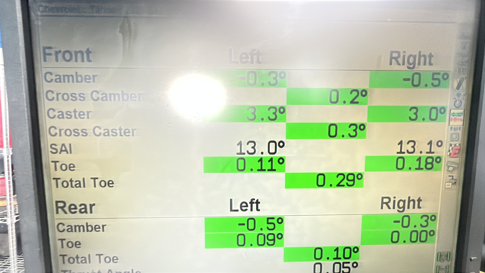

Took it to work to use on the super flat floor. I used some folded up poly sheeting to drive the tires onto to act as an friction reducer which worked very well. As did the home made plates. I wound up being a 1/2" too much of toe in. 5 cranks on each side brought it spot on. Really neat to watch the measuring tapes move as you adjust the toe. Seemed very accurate movement. Very happy to have this home made tool added to my arsenal. Drives great now. I even used it to check the camber angles while I was at it. I used a 4' level to level the gauge with, then just held the gauge against the plate to get a reading. Worked very well. And the size of the plates gives you a much better visual comparing to the rest of the vehicle.

You can even tell just by looking at those last 2 pics my driver's side camber is more positive +1.5* than the pass side which read dead on 0*. The large plates really bring out the visual.
