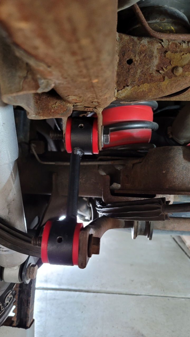

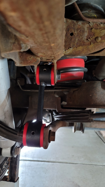

Doooooood. I just looked up the DJM stuff for another member with a NBS and the pic of the kit I saw had sway bar links with less offset. The ones you have look like mine on my NNBS. I didn't think there was any real difference between the two generations, and maybe that's just a stock photo. But I had to mention it, just in case.
DJM RK2000: https://djmsuspension.com/product/rk2000/
I had seen that as well, I figured it was a stock photo as well. But zooming in on it now, the instructions show RK2000, which is the same part number as what I ordered and received. I'll reach out to them today and see what's up.

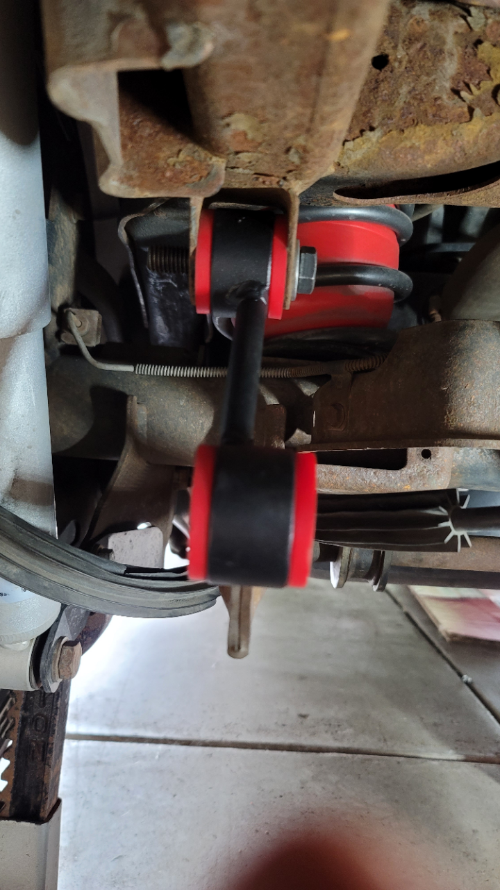

OK, slow to follow up on this. I talked to DJM and they basically said the link looks fine. So, I tried reinstalling. Lifted the rear of the vehicle, axle sitting at ride height. Shifted the bar over to the new mounting spot on the driver side. Installed the driver side link and it shoved the sway bar right into the shock on the pass side. I can't even get the bar lifted up far enough to bolt up to the pass side link. I sent DJM pics again, waiting for a reply.

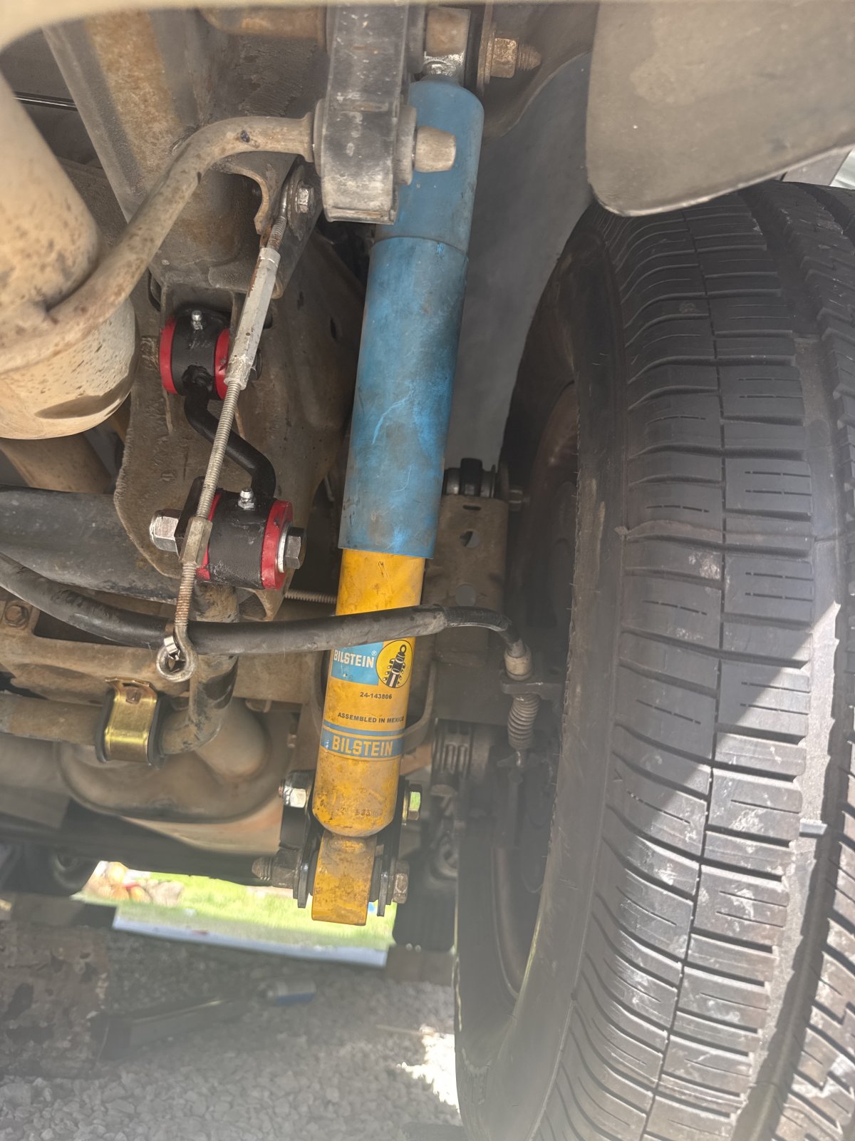

Have a pic looking up at the drivers side alignment similar to their instructions?41944827-E2DF-4AD7-B2DE-A746EF3037A9.jpeg
ks03
Fool Excess Member
May 3, 2019
307
298

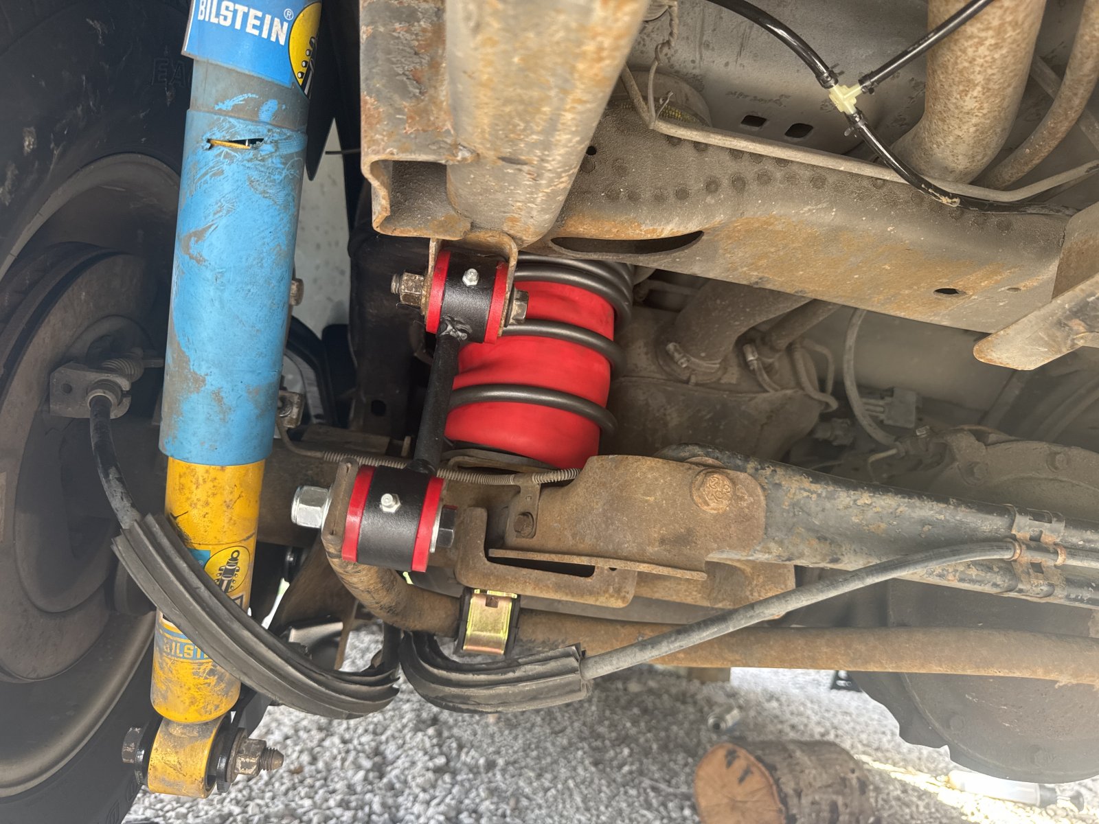

View attachment 247612 So i ended up 180 on the driver side and left the passenger side the way it was. It was the only way I could fit the link inside the sway bar. The instructions show a picture with the bar on the inside but mention to bolt it to the outside. My axle is centered and there is no contact at all so I’m happy.
looks like you’re not the first, and the directions maybe wrong, sounds like flipping the driver side link to switch the direction of the off set, and mounting the bar to the outer side worked for that guy
wording from the instructions are
Apply some grease to the bushing and bolt the driver side end link to the factory upper mount using factory hardware. The lower end is offset to the passenger side. Bolt the sway bar to the outside of the end link using 1/2” x 2-3/4” bolts (Fig # 7).
Which is opposite the picture in the instructions, but how it is in the first attachment in this post

OK, after getting back under there, flipping the driver side won't matter since I think the passenger side link is still welded wrong. The passenger side link will still be in the same position, unless I put serious tension on the sway bar, which will end up snapping an end link. The passenger side end link is pushing the sway bar out too far, causing it to interfere with the shock. If the welds were both centered on the end link, it would pull the mount point for the sway bar away from the shock.
