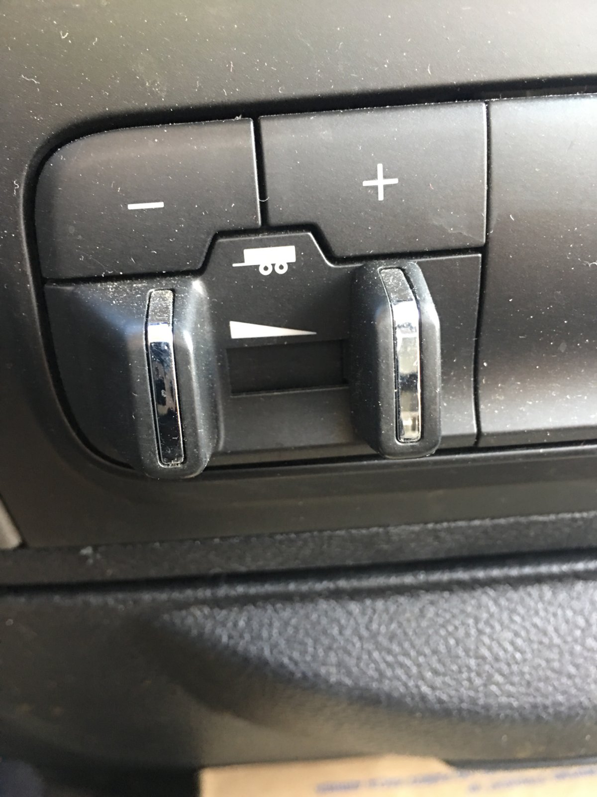

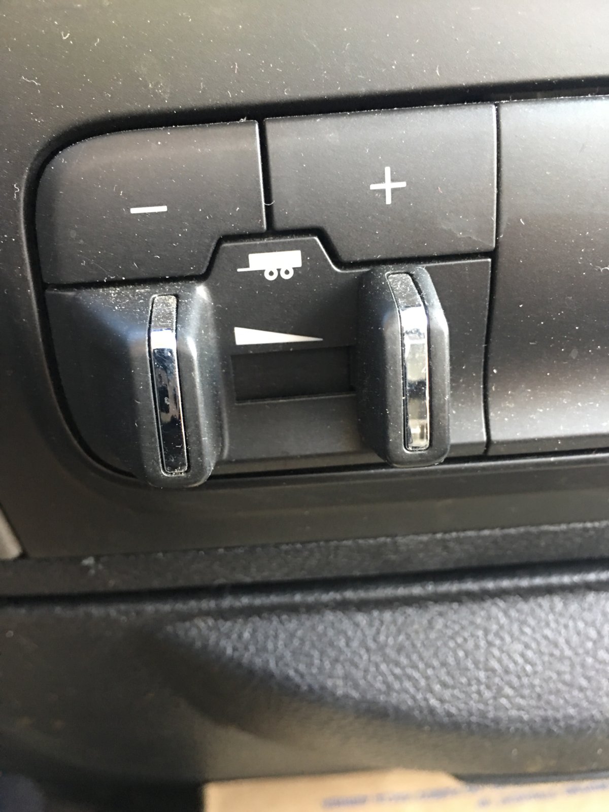

They still would have to have a manual brake control somewhere in the dash. As refined as they are there is no getting around that...something like thisimage.jpg
