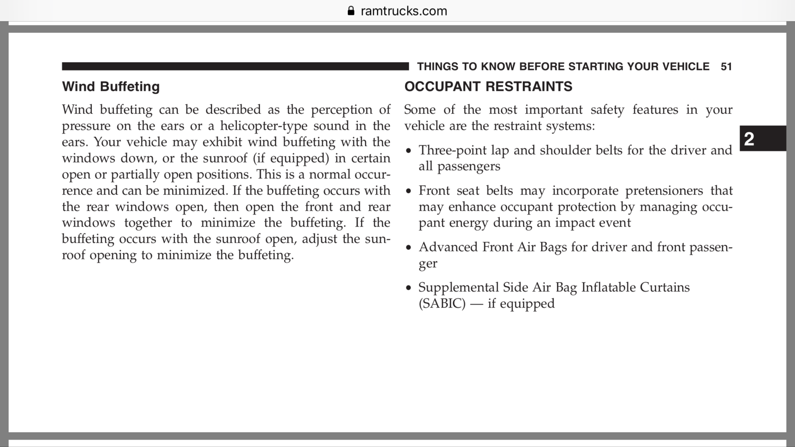

you know if you roll down just a back window or back windows your going to get buffeting on virtually any car/truck, doing something like that is purposely making it happen, the fix for that is to just crack a front window on the adjacent side or both front windows. I think were trying to determine if this happens with all the windows closed.
