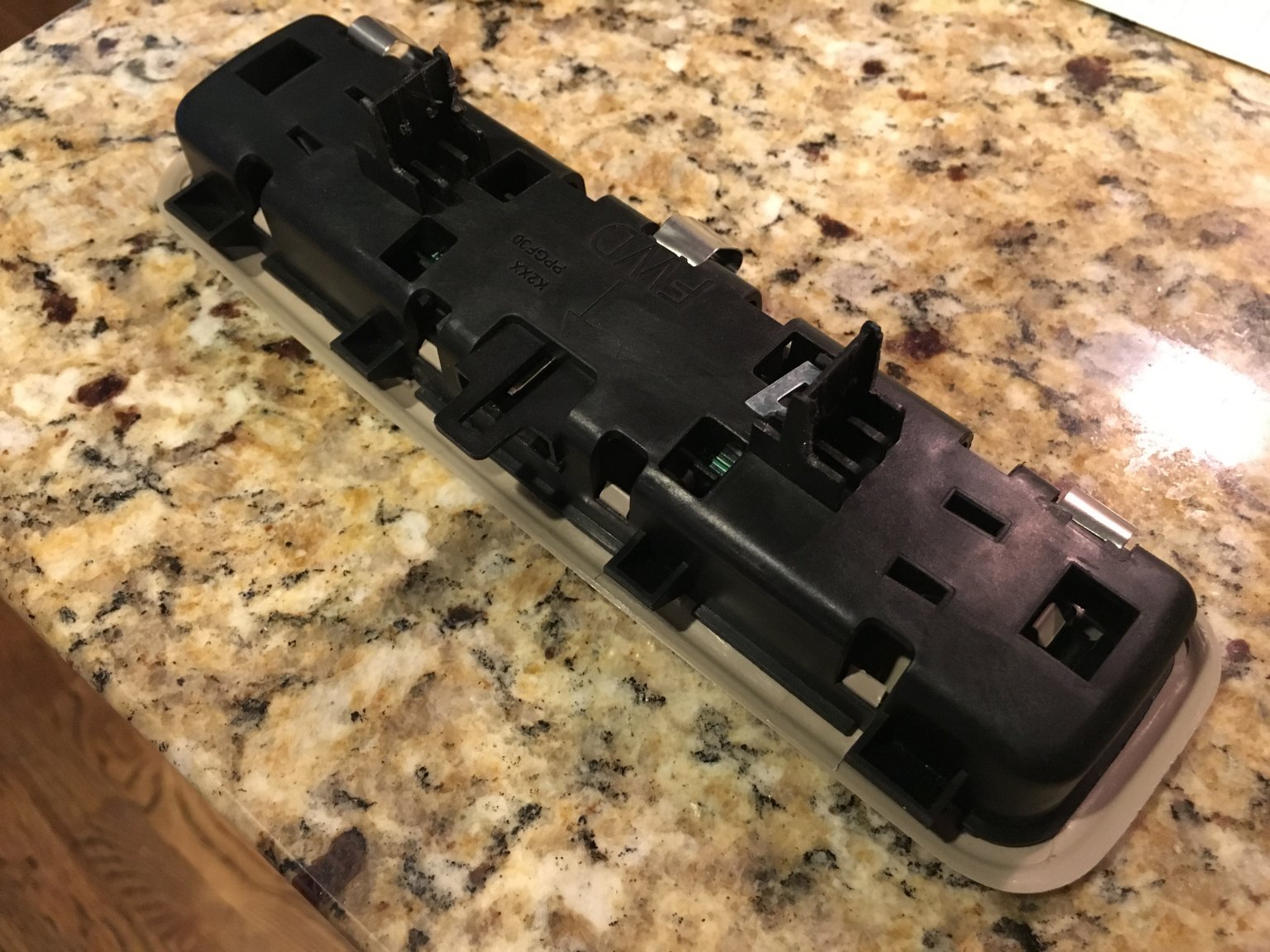

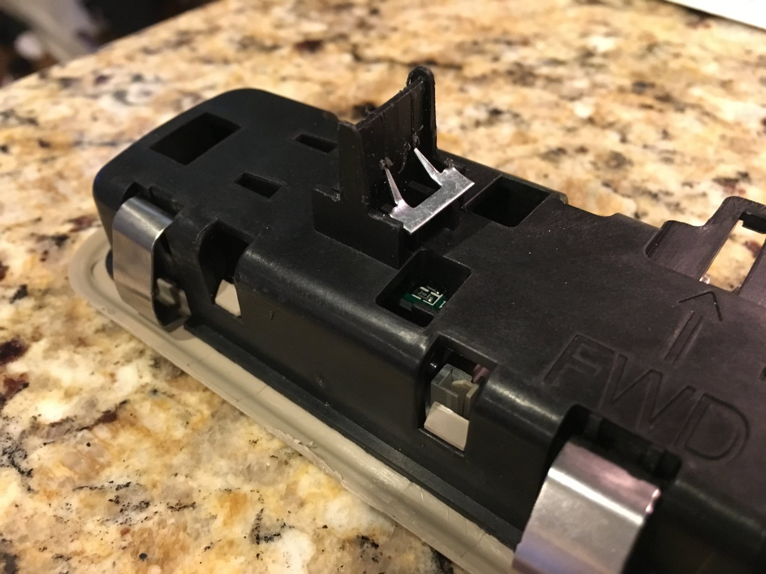

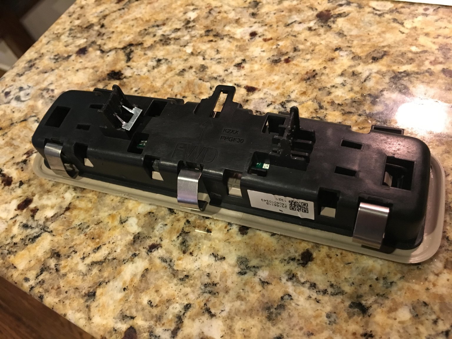

Here are some pictures. You can see the three metal tabs at the rear of the assembly and the two plastic tabs that I broke the metal pieces off of. Part of one of the metal pieces is still attached.
T
Tregs
Jan 2, 2016
35
CP,
Thanks for the pictures. I now see exactly what you're talking about. From the pics, I don't see a way to remove the assembly without breaking the tabs. Since I doubt I can buy the tabs, it looks like I will have to buy a new assembly if I choose to remove it. $53
I tried to pry out the metal tabs but can get an angle that allows contact.
Any ideas?
Thanks again for the pictures.

Is there a connector on the back or sides of the assembly for the power wire? 2 wires, hot and ground? Or is it grounded through the metal tab into the roof?
Thanks.
ColoredPencils
Apr 9, 2016
15
13
Yes there's a 4-wire harness. If you look at the last picture I posted, the harness plugs in right at the end of the FWD arrow.
T
Tregs
Jan 2, 2016
35
I see. That makes sense. 2 wires for courtesy lights with open doors and 2 wires for switched power at all times.
