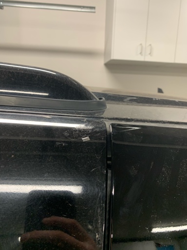

Hey guys
I’m trying to get the door I bought from the dealer installed but having a few issues. Done some fiddling but it seems door is still to close at the top and in to far on the bottom. Harder for pictures to capture it but hopefully it showsIMG_0448.JPG

Keep fiddling is my guess. Honestly, looks like pretty run of the mill GM "tolerances" these days to me.

There should be a little room to play if you loosen the 2 hinge bollts. By doing top or bottom or both hinges, you should be able to get the door seam even.

Also the door striker can be positioned a bit up or down by loosening the two T40 bolts

Got it thanks guys!
