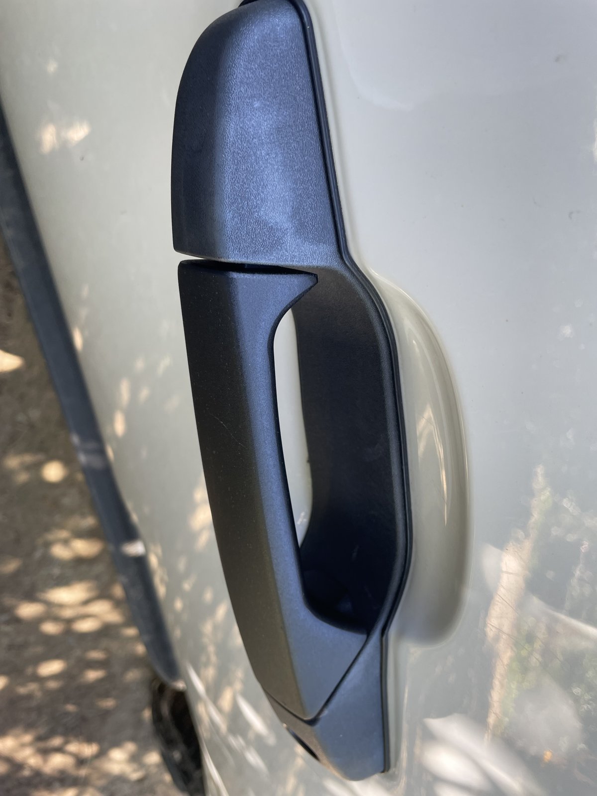

Hey folks,
We have a 2011 suburban, and the wonderful plastic on the chrome exterior door handles has broken. It is probably due to how my kids open it in combination with the poor design. Anywho, I replaced one of them with an aftermarket handle, but the handle is very tight, and my smaller kids can’t even get it open. So…my question is…is there an adjustment in the door to make it less difficult to open or is there a specific manufacturer of door handle that anyone with experience can recommend? Btw, I don’t need to worry about a keyhole because these are the rear handles on both sides.
TIA!

Yeah, it’s not a difficult job. I just want a quality part since the one I previously installed isn’t performing well.

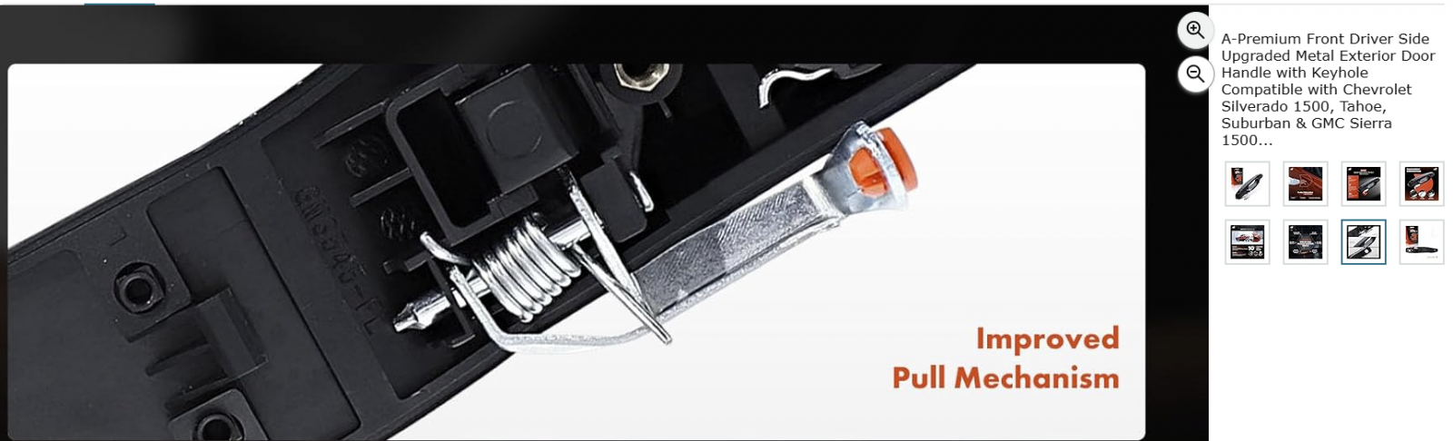

I'd suggest checking FB Marketplace, Craigslist, and/or eBay for recycled door handles. Also, the ones on my daughter's Sierra turned out to be steel. I love my mechanic! This last round, they couldn't break the door handles. Unfortunately, they bent the door trying to get in. But she lost nothing inside.

So will Escalade handles... :) That's what I have on my Silverado.
Are they any stouter??
Mine came w/the lovely plasti-chrome handles. I broke then replaced two of them, Then pulled them all back in '15(?) for some el cheapo textured blacks I got off jeffazon when I was going through my plasti-chrome delete phase lol
I may have to start anew on this subject. I'm wanting some that feel (and are) better made
