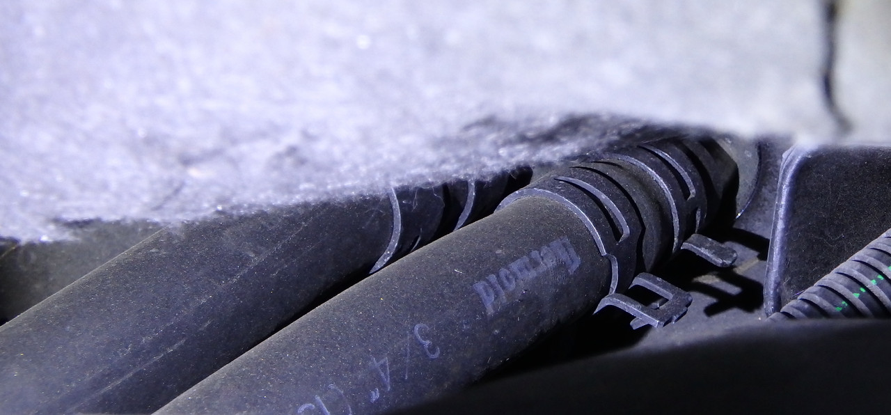

I got rid to the "Tees" entirely and eliminated this failure point. I don't need the rear heat, and I'm enjoying loads of extra engine room, and easy access to the rear plug & wire. I also don't have to worry about the rear plastic fittings failing either.
I took a length of 3/4 inch heater hose, warmed it up a bit with a heat gun, pre stretched it a little bit, lubed it with anti-freeze and shoved it over the heater core tube (past the raised flange portion). Then put two hose clamps on each one (one before an one after the1 flange portion). Then I put an in-line 3/4 to 5/8 metal hose adapter to get back to the stock hoses. And I cut out the aluminum tubes, in the engine compartment, that go from there to the rear heater core. Works great, eliminated multiple failure points, and gives me much better engine access.
31,465
46,613
Have some pics?
