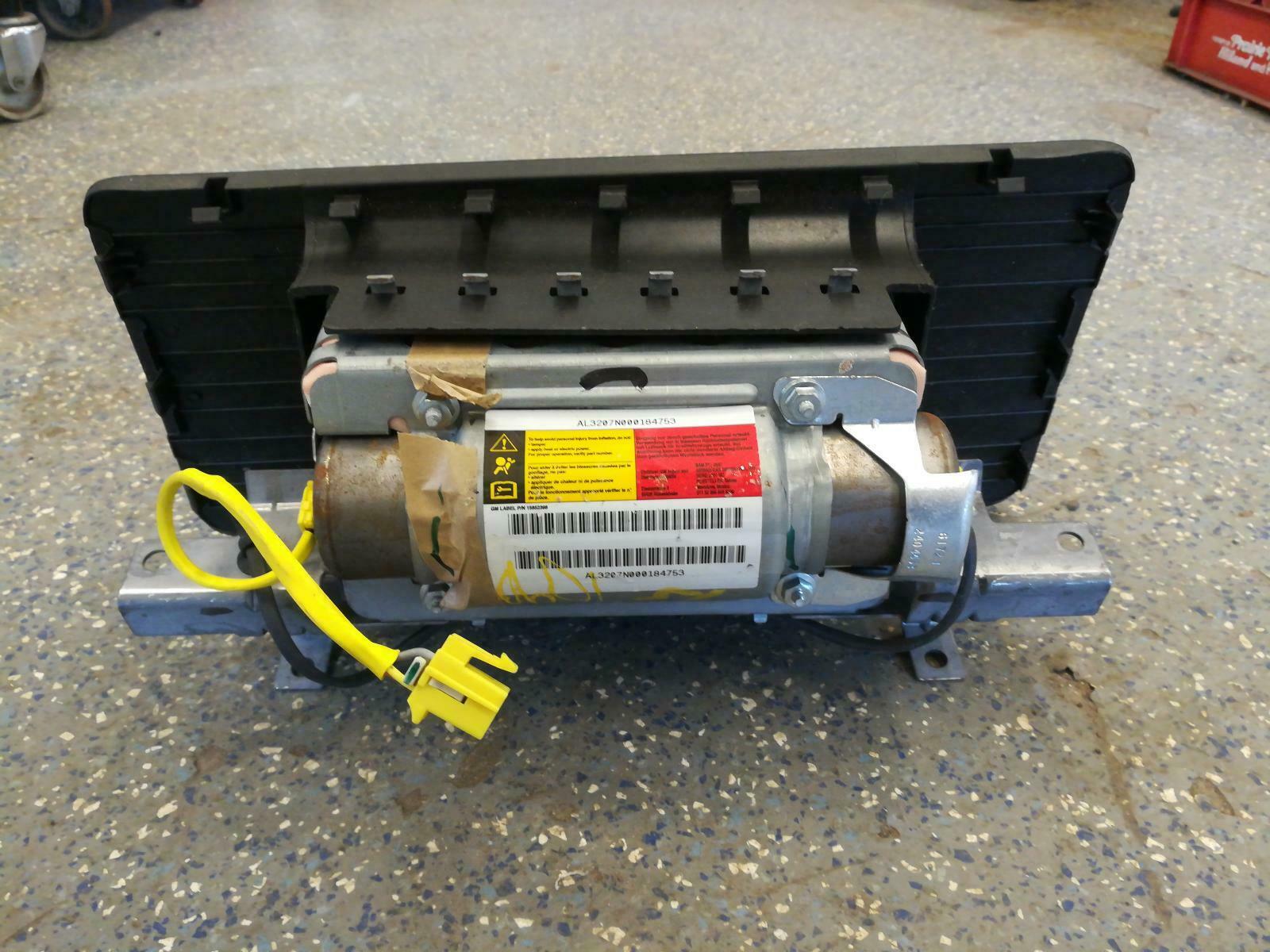

just keep your receipt so you can get a refund when they actually do get sued and replace the air bag GM really did set them selfs up for a mega sized lawsuit when someone gets killed..
don't worry they can't sell recalled items it's illegal as the consumer protection law adds significant liability
as you can see this recalled one is PRIMED and ready to explode like a IED right n your face
as you can see the rust that means it was exposed to heavy amounts of moisture
A

Thanks for the reply, I assume you have had yours replaced per the picture? If so, what is the part number of the one in the pic? I cant seem to make out the last few digits. Also, Did you install a bag with the “2” model number?
