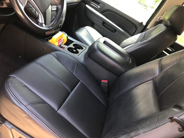

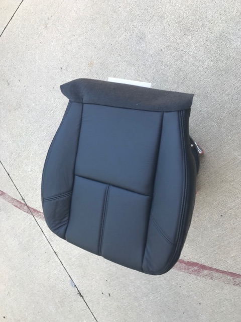

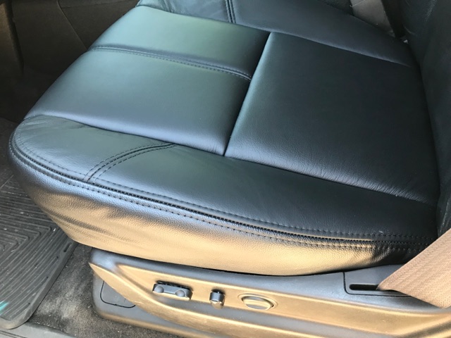

Just completed the Seat Pad and Cover today with great results. This is the second one of these I have done in the past month. I also did the driver seat in my DTS. This is way easier than the Cadillac, just by virtue of the wide open access and ease of removal and replacement of the seat.

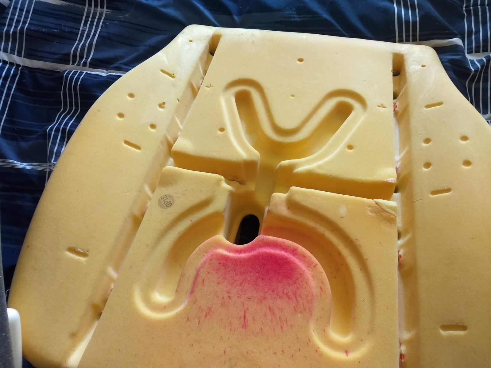

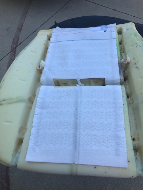

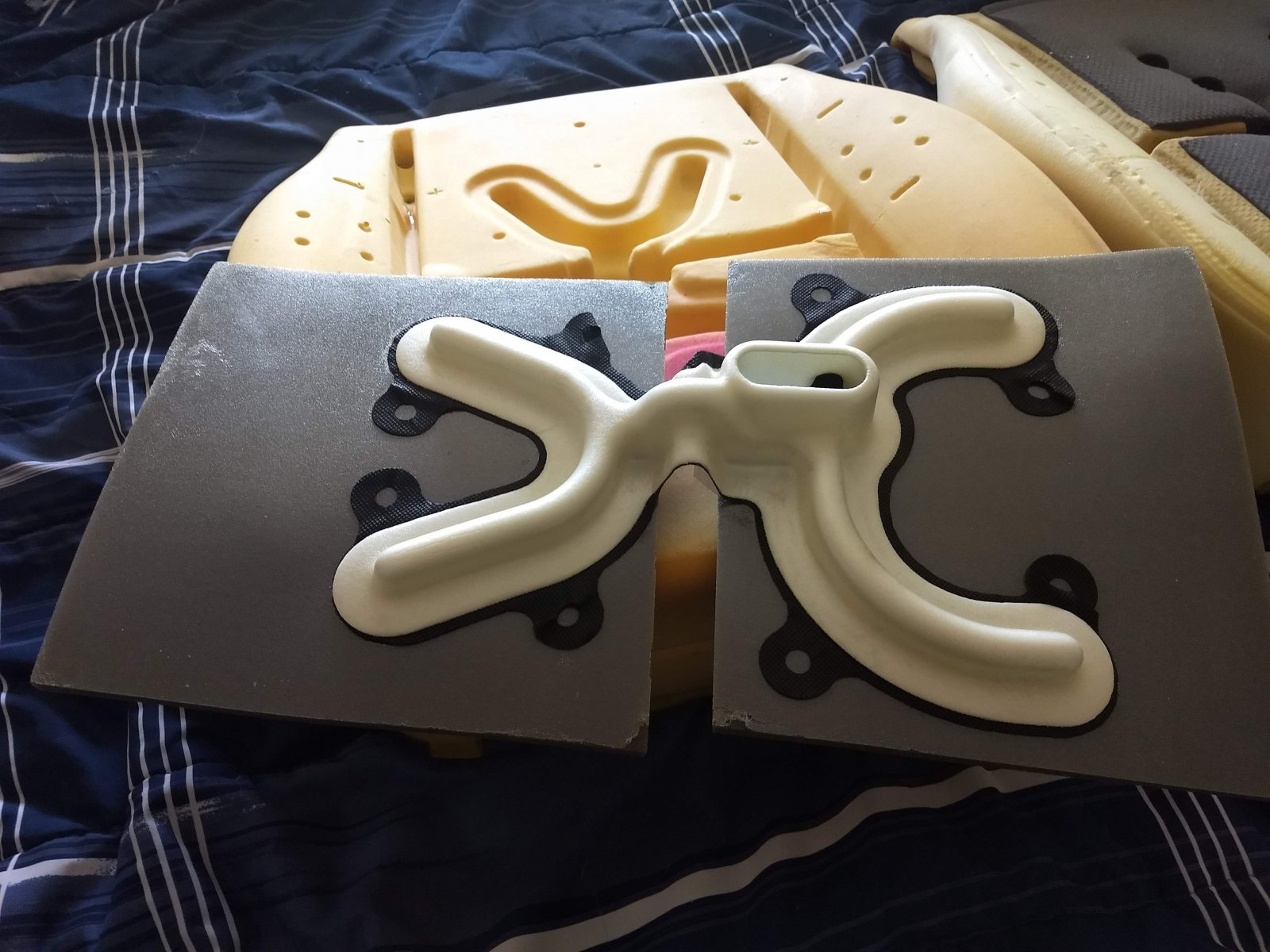

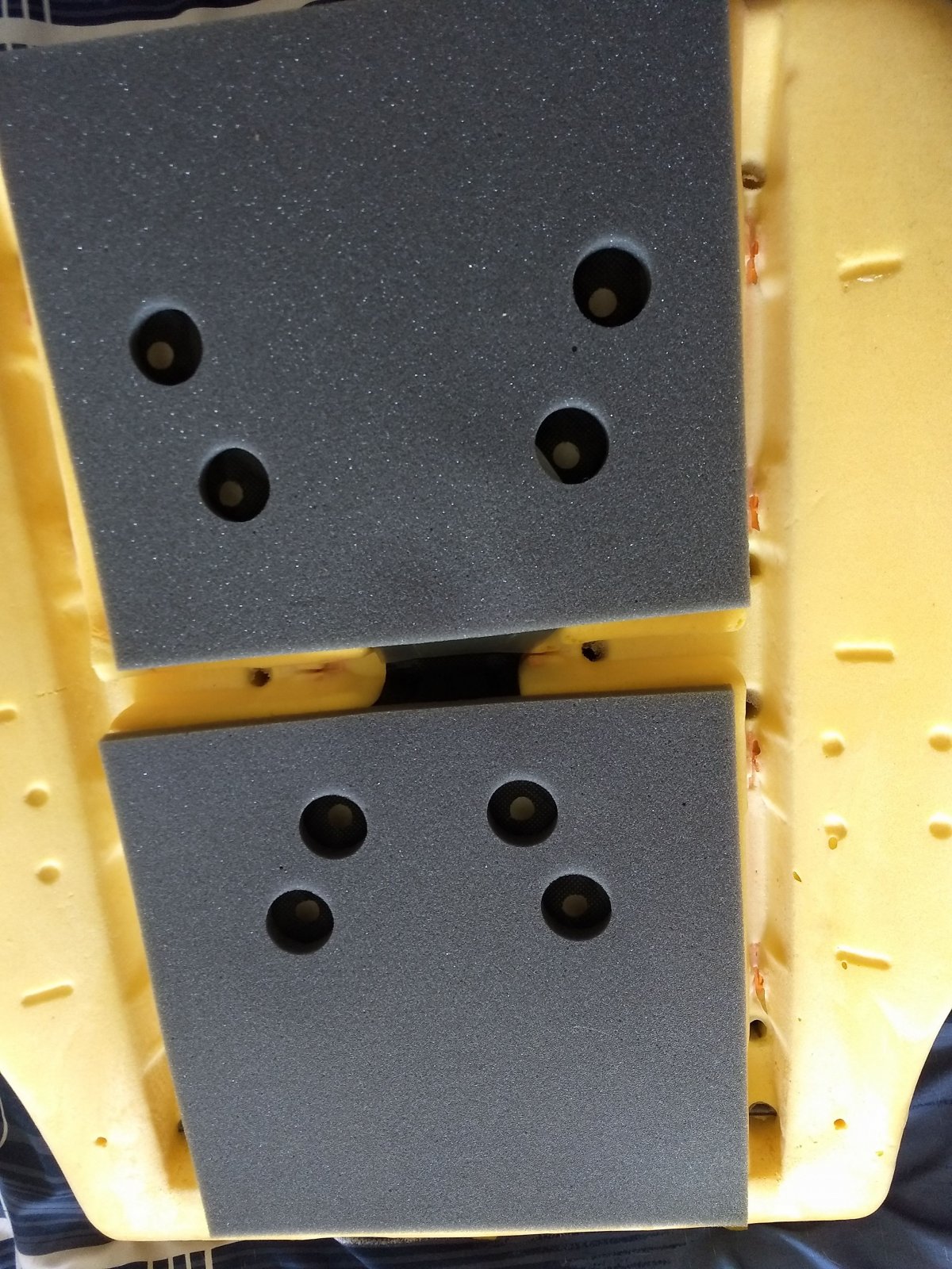

Step 1 - Dont Do this! (Pre-assembly of the Pad to the cover if you have heated seats) I preassembled and regretted it because its very difficult to remove the clips from the seat pad if you need to disassemble as I did. The Seat Shop on line Video showed the heated seats as being a blower type with Vent holes. I found out that it is in fact a heating element which needed to be put in place to the foam before assembling the pad. Live and learn, take the You Tube videos with a grain of salt.

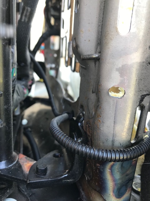

This is the seat just removed from the Truck. The plastic Garbage bin top serves as an excellent portable workbench, just the right working height. You need a surface to rotate and flip the seat in order to replace the pad clips. Seat is heavy, use a pad or old blanket to cover the sill plate for removal and install. Lift off the plastic trim covering the fasteners holding the seat to the floor pan.
To remove the seat Use the Vim tool Socket for the 2 front Torx nuts and the 11 mm for the rear 2 Star bolts. Remove the little plastic panel (see above) use T50 Torx driver to remove the seat belt bolt.
Move the seat forward and remove the seat air bag connector and the Power connector. I removed the fuse for the air bags on my Caddy before removing the seat air bag connector , didnt do it on the Tahoe.
Lift the seat from the truck to the bench

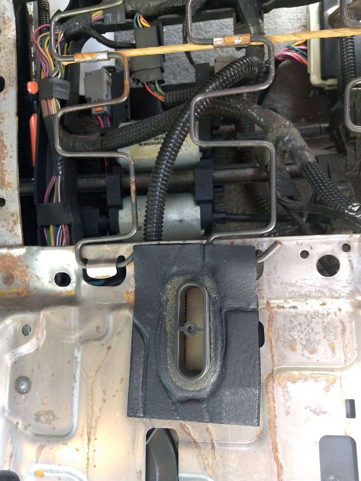

Remove the seat controls panel shown above either before of after removing the seat from the truck. Very easy just a few spring clips and one 7 mm fastener at the front. Tricky to remove the 2 electrical connectors, but you want this panel off and not in the way.
